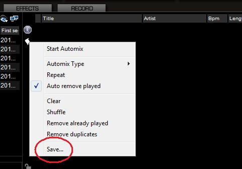

@John - Pionara has your best solution but missed one critical point. Once you have your playlist set-up in the sidelist, click on the paper icon and click save so that you have the playlist for future events and/or reference.
