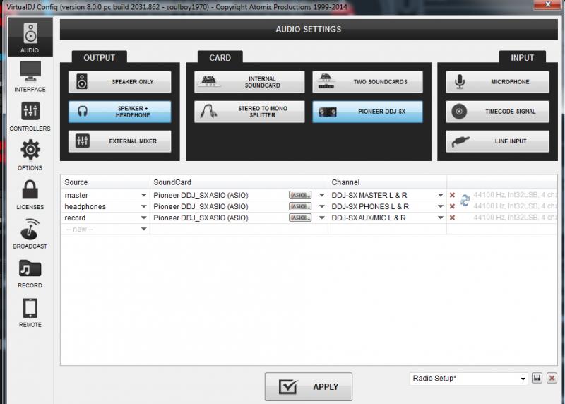

Hi guys I have just installed an new SSHD in my pc and now have just plugged in my DDJ-SX but I cannot get sound out through my PC's internal soundcard.
My Audio settings on VDJ8 are as per the pic below (the mic source should actually be 'record')
I have RCA's going out of the DDJ-SX into the mic input of the PC soundcard but not getting anything coming through.
Anyone have any suggestions please on how to resolve this - Its work perfectly before so I know it just a set up issue probably on the PC soundcard but for the life of me I can't seem to work out what the problems is and I am meant to be broadcasting a radio show tomorrow using simplecast - hence the need to use this setup
Many thanks

is there some reason you cant use the built in broadcast function and skip the looping back through internal soundcard ?
or is this simplecast not connecting to a shoutcast or icecast server? not really sure what simplecast is.....
anyways check that u are recording from the mic input in the windows mixer i assume you are using windows? also i think the windows mixer can record and mute output so u don't hear it so check that its not muted the output in the windows mixer. all this is assuming you are using windows of course.
as a side not best practice is not to do any upgrade close to a performance date :-)
geposted Sat 15 Nov 14 @ 9:44 am

btw u don't set a recording source to do a lookback into the soundcard inside vdj :-) the previous screen was correct for the vdj audio config

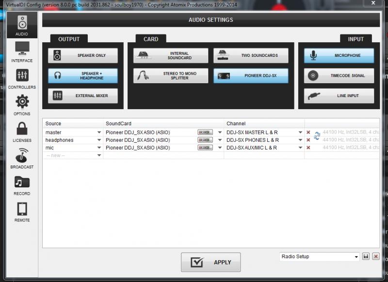

have a look at the vdj audio config if you have it as it appears in the second post the mic wont work
u need to have the mic as it appears in the first post
u can record your mix in vdj with out setting anything to record in audio config
geposted Sat 15 Nov 14 @ 11:12 am
Edited....
Remember, the mic is plugged into the SX, after the sound has left VDJ. If you record from the VDJ mixer, then you're recording the signal before the mic has been added.
Feed the analogue output of the SX back to your computer audio input and stream from that.
geposted Sat 15 Nov 14 @ 11:19 am

Ok so if I just have the first 2 sources in the audio settings master / headphones I get sound through my monitor speakers but as soon as I add either a record source or a mic source I lose sound through the monitors - these are connected via RCA - jack lead out of the master out on the SX.
I have done another test stream and the mic output is still not being recorded even though it is showing a signal being received on the channel of the SX (chl 4)
Is there anything else I can try?

you will need to go back to the loop back into the soundcard sorry to say that but its the only way to get the mic into the stream with the SX since the SX does the mixing in hardware not in the software.
geposted Sat 15 Nov 14 @ 11:41 am
Sorry wicked but could you elaborate on what you mean by going back to the loop back please as I don't understand what you mean by this
geposted Sat 15 Nov 14 @ 11:43 am
send the output of the SX into your soundcard via the mic input or Aux input and broadcast via the simplecast program sorry i know its a step backwards but with your setup its the only way to get the mic broadcasted.

lol that was me trying to help someone else out now look where I am !!
This was the exact same settings I had before the new hard drive went in and it worked perfectly
master Pioneer DDJ_SX Asio (Asio) DDJ-SX MASTER L&R
Headphones Pioneer DDJ_SX Asio (Asio) DDJ-SX PHONES L&R
record Pioneer DDJ_SX Asio (Asio) DDJ-SX AUX/MIC L&R
I really can't understand why it is now do complicated to get it working again.
When I open VDJ it prompts me to use the SX soundcard - should I accept this?
If changing anything in the Audio Settings do I need to restart VDJ / SX or both?

Yeah, there's even an official PDF setup document here
that says the same thing - you should be able to record like you say (from ASIO aux/mic).
It's one or the other though. If you can get a signal to stream by feeding the SX output back to the PC with a cable and it works, you don't need to set the software to record the loopback as well.
geposted Sat 15 Nov 14 @ 12:18 pm
exactly Groovin like I said that was how it was set up before and it worked so I'm at a lost as to why it doesn't now ?
