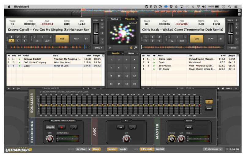

is it not time VDJ had a built in EQ?
Image below is from Ultramixer software

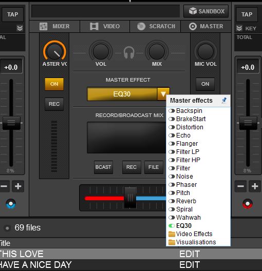

Downloaded,
Actually i can see that i had downloaded it before, but like a lot of things with this software how do you get it to work? your screenshot is interesting, i do not see the eq on my software.
geposted Wed 25 Oct 17 @ 4:59 pm
You need to assign it as a master effect then activate it. I agree it's not overly obvious for those not familiar with using effects.
Note: It won't work if you are using external soundcard configurations like MC6000 Mk1, like Sandbox it's for software mixing only.
I agree it's not overly obviouls for those not familiar with using effects.

Should work just fine then.
Go to the master tab, select it from the list then click the selected box to activate it. simple as that.

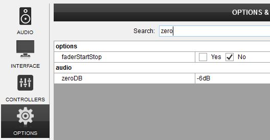

You maybe need to lower the zeroDB setting.
I've not used it in ages since I got rid of the Pioneer SX2 but I use -6 as standard these days.
geposted Wed 25 Oct 17 @ 6:05 pm

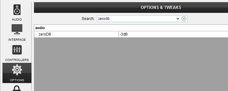

In the regular settings->options->zeroDB
It's a general setting for all master output from VDJ
Mine is usually set to -3db
geposted Thu 26 Oct 17 @ 2:23 pm
It's in options as below.
Thanks,
Set it to -12 and the master volume on my skin to 50%

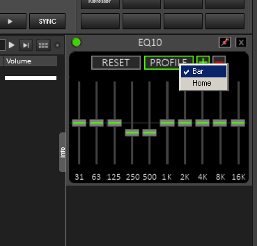

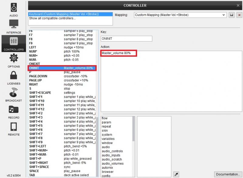

freppaPRO InfinityMember since 2002
You could use this aswell.
geposted Sun 29 Oct 17 @ 12:41 pm

dj5826PRO InfinityMember since 2008
I love the 10 band eq, I just find that any slight movement on a fequency has a major impact on the sound output. Any suggestions on how to make the eq less sensitive?
geposted Thu 02 Nov 17 @ 1:18 am
Wanted to refresh my post from earlier this month.
I have the master output on 33% (which is probably irrelevant), but any slight movement on any frequency has a massive effect on the sound output. Please advise how I can limit the eq's effect so I have more headroom on the frequency sliders.
TIA
geposted Tue 14 Nov 17 @ 11:25 pm
I agree with you that the sensitivity on the EQ (30) is a bit to sensitive.
Dont know about the master output, but to get headroom you dont have to lower the volume that much (I have it set at 80%).
We could ask Scott that made the EQ if he could make it less sensitive, please ?
geposted Wed 15 Nov 17 @ 3:10 pm
