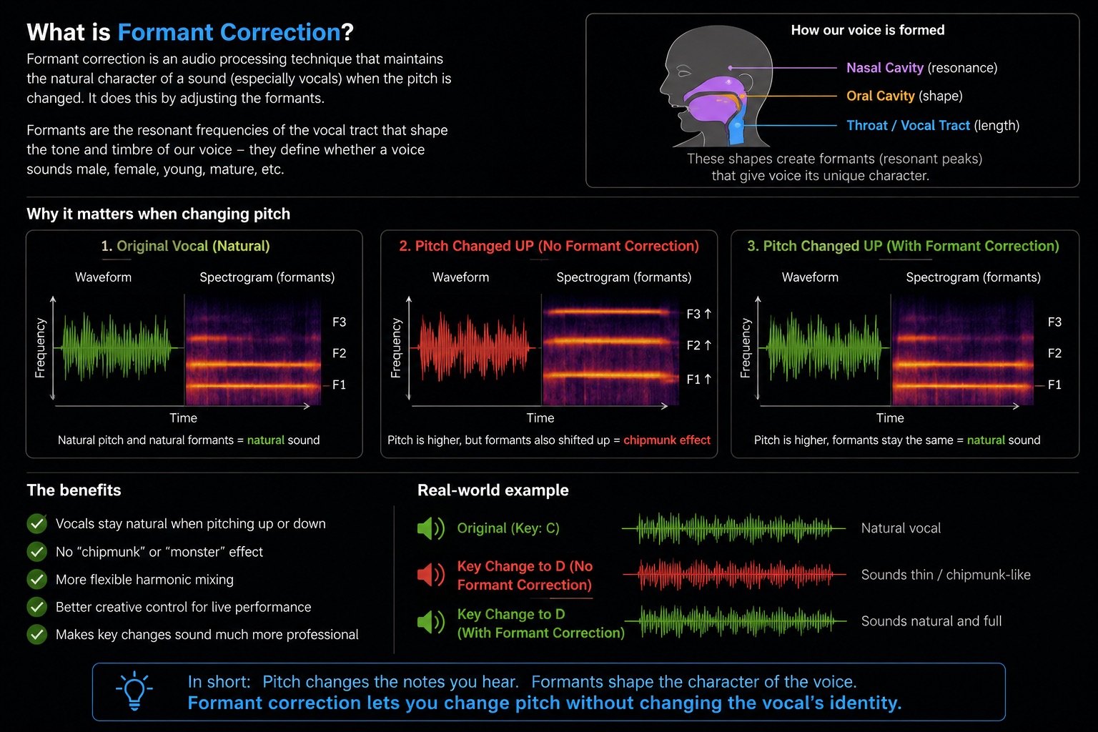

Thanks for the replies. I think there may be a slight misunderstanding about what I mean by formant correction.
I am not asking for the vocal stem to be transposed into a different musical key from the instrumental. The whole track would still be shifted by the same number of semitones, so the vocals and instruments would remain harmonically aligned.
The issue is that a vocal contains two different things:
Fundamental pitch, which determines the musical note being sung
Formants, which are resonant frequencies created by the shape and size of the singer’s vocal tract
When an ordinary pitch shifting algorithm moves a vocal upwards, it often moves both the musical pitch and the formants upwards together. The notes are technically correct, but the singer’s vocal character becomes thinner, smaller and more “chipmunk-like”.
Moving the pitch down can have the opposite effect, making the voice sound unnaturally deep, heavy or “giant-like”.
Formant correction separates those two elements. The musical pitch is changed to the new key, but the vocal resonances are compensated so that the singer retains more of their original vocal character.
For example:
Original vocal
Pitch: 0 semitones
Formants: unchanged
Ordinary pitch shift
Pitch: +3 semitones
Formants: also shifted upwards
Result: correct musical key, but the voice sounds noticeably smaller and less natural
Pitch shift with formant correction
Pitch: +3 semitones
Formants: kept close to their original position
Result: correct musical key, with a much more natural sounding voice
This is different from Master Tempo or Keylock. Those features allow the tempo to change while trying to preserve the original musical key. I am suggesting improved processing for the opposite situation: deliberately changing the musical key while preserving the natural vocal timbre as far as possible.
Applying it only to the vocal stem was simply one possible way of reducing processing demands. The instrumental stems would still be transposed by the same amount, but they generally do not need vocal formant correction.
Cubase and various other pitch processing systems already provide separate pitch and formant controls. I am suggesting similar compensation could improve VirtualDJ’s Key Match and Key Cue results, particularly when moving a song by several semitones.
Here is a diagram that attempts to explain formants visually.
geposted Sun 26 Jul 26 @ 1:14 pm
I assume this infographic is AI generated and the spectrograms and waveforms shown there are garbage illustrations that don't actually have any meaning?
Other than that, I haven't looked into the details yet, but the difficult thing may be recognizing the formants in the first place. While in a DAW you probably have a separate track for each singer, VirtualDJ only has access to all vocals together, which could include multiple singers, even at the same time.
geposted Sun 26 Jul 26 @ 1:22 pm
Yes, the infographic was made as a simple visual explanation. And just to show what waveforms and spectrograms look like, those weren't from a real recording, so please ignore those particular graphics.
What I was trying to say is, still the written explanation. In a program such as Spectralayers (Steinberg), you can identify the formants and from a vocal and preserve or not preserve them when applying stretch and pitch functions.
I agree that a full commercial recording, or even an extracted vocal stem with several singers, is more difficult to process than an isolated monophonic vocal. Overlapping singers, harmonies, reverb and stem separation artefacts would make accurate processing more difficult.
However, I don't think the system would have to identify each singer individually or explicitly recognise a fixed set of formant frequencies for each voice necessarily.
As far as I know, pitch shifting that preserves formants can be done by estimating the spectral envelope or resonant character of the signal over time, shifting the underlying pitch and then compensating the spectral envelope such that it doesn't just go up or down by the same amount.
In other words this:
Pitch shift only
Original pitch structure -> Up 3 semitones
Original spectral envelope +3 semitones also moved
Result → musically correct, but the vocal character becomes unnaturally small or bright
While this:
Pitch shift preserving formants
Original pitch structure -> transposed up by 3 semitones
Original spectral envelope → preserved in about original frequency region
more of the original vocal character preserved, but musically correct
This is not some theoretical feature. For example, Steinberg’s pitch processing is formant-preserving, so that the formants remain where they are as the pitch changes, and you don’t get the familiar “Mickey Mouse” or “monster” effects.
WaveLab also allows you to correct the formants of vocal material and includes specific methods for monophonic, speech and multi-purpose material.
It doesn’t mean it would work flawlessly on each and every mixed or stem-separated recording. Presumably multiple singers at once would reduce accuracy . There may need to be different quality modes depending on available CPU . Thatt being said, even an imperfect formant preserving mode might sound much more natural than simply shifting the entire vocal spectrum up or down with the key.
Therefore my initial idea of placing it on the vocal stem was not about changing the vocal to another musical key. Each stem would still undergo exactly the same pitch change. The idea was simply to apply the additional formant compensation where it would be most useful, rather than expending the same processing effort on drums and other material that does not contain a human vocal tract.
So I accept that it might technically challenging to implement. The feature request is basically asking if a better quality, formant-preserving pitch mode could be investigated, not claiming it would be trivial to implement.
