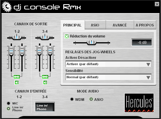

1. Connect your microphone to DJ Console Rmx microphone plug (on top or front).
2. Run VirtualDJ 5 DJC

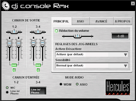

3. Open DJ Console Rmx control panel and set the microphone as sound source on input 1-2 (instead of the line input)
Remark: you must set DJ Console Rmx Mic as input 1-2 AFTER starting VirtualDJ, (since starting VirtualDJ 5 DJC sets the Line-In as input on channel 1-2).

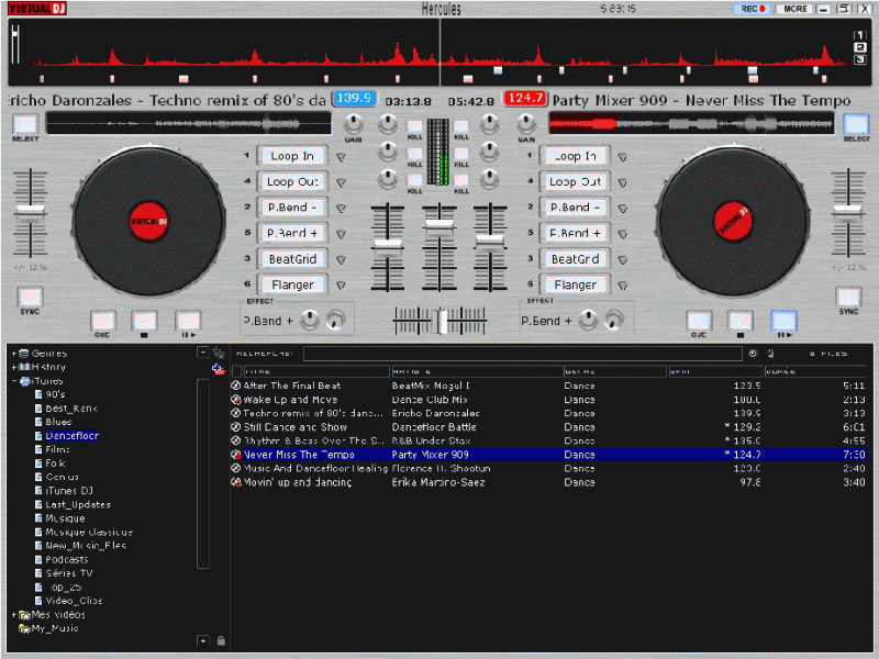

4. Load on deck B (right) the music track you want to play, and place the cross-fader in central position between deck A and deck B.
5. Push down on “Source 1” button on DJ Console Rmx, and release the button, which becomes blue.
6. If you talk in the microphone, you hear your voice in the mix. You don’t need to push on DJ Console Rmx Mic On/Off button.
7. Talk or sing in your microphone. You can adjust the microphone settings with:
- DJ Console Rmx Mic Volume and Gain buttons to set the microphone level,
- DJ Console Rmx left deck Bass, Medium and Treble button to set the microphone equalisation.
8. Click on VirtualDJ REC button, type the name of the music you will record, and click on Save to start recording. The REC button has a red dot during the recording session.
9. Click again on VirtualDJ REC button to finish the recording. The REC button loses its red dot when the recording is finished.
10. Push on Source 1 button again to switch off the external source on left deck, and to recover the computer audio as source for the left deck.
=> You have recorded the mix of your music on right deck with your voice on the microphone on the left deck.

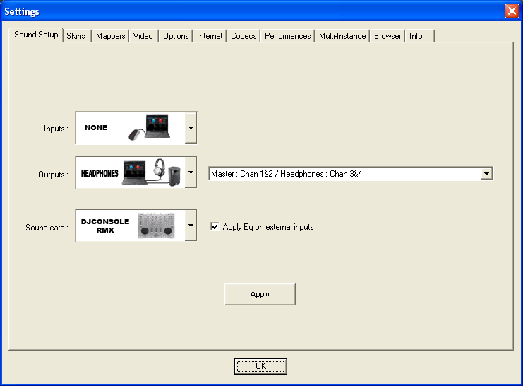

a) In Windows (ASIO)
Switch in ASIO mode in going to VirtualDJ Config menu, to the ‘Sound Setup’ tab and check the setting ‘Apply EQ on external inputs’, then click on ‘Apply’ and ‘OK’.
You can check you are in ASIO in DJ Console Rmx control panel.
On DJ Console Rmx controller:
- push on ‘Source 1’ button to activate input 1-2 (or Source 2 if your source was on input 3-4)
- move the crossfader to deck A for input 1-2 (to deck B if you use input 3-4).
In VirtualDJ, go to the Record menu, click on the config button in the record menu and choose choisissez ‘Record from Master’.
Click on ‘Start Recording’ to record.

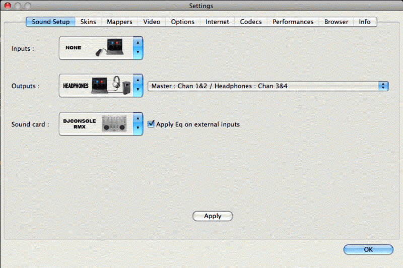

b) In Mac OS
Go to VirtualDJ Config menu, on ‘Sound Setup’ tab and check the setting ‘Apply EQ on external inputs’, click on ‘Apply’ and then click on ‘OK’.
- push down on button ‘Source 1’ if you use input 1-2 (‘Source 2’ if you use input 3-4)
- move the cross-fader on the side of the source, deck A for input 1-2, deck B for input 3-4.

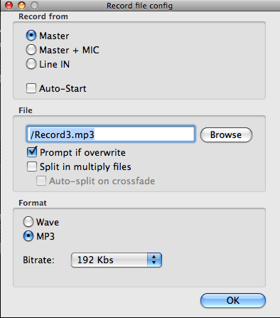

Go in VirtualDJ Record menu, click on the ‘Config’ button of this Recod menu Record, and choose ‘Record from ‘Master’.
Don't change the recording folder from the default MacIntosh HD. Click on OK.
Then click on ‘Start Recording’ to record.

- Si votre logiciel le peut, vous pouvez diriger la pré-écoute sur la sortie 1-2 (afin de bénéficier du pré-amplificateur casque intégré à votre carte sonore) et le mix sur la sortie arrière (sortie 3-4 ou 5-6).
Par exemple, dans VirtualDJ 5 DJC avec le DJ Control Steel, cliquez sur le bouton “More” et allez sur l'onglet "Sound Setup"
- dans le champ ‘Outputs’, choisissez ‘Headphones’
- dans le champ ‘Sound card(s)’, choisissez ‘4-out Card’
- dans le champ ‘Driver 1’, choisissez ‘USB Audio’
- dans le champ ‘Output Channels’, choissiez ‘Master : Chan 3&4 / Headphones : Chan 1&2’
et branchez votre casque à la sortie 1-2 et vos enceintes à la sortie 3-4.
Si vous trouvez le volume trop faible dans votre casque :
- retournez dans le programme Mac OS 'Configuration audio et MIDI',
- Sélectionnez les propriétés de ‘USB audio’,
- dans le paragraphe ‘Sortie audio’, déplacez vers la droite les glissières 1 et 2 (la sortie casque est la sortie 1-2) jusqu'à ce que vous obteniez un volume sonore satisfaisant dans votre casque.
