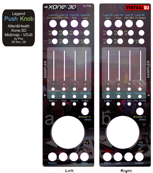

Within this page is an updated VDJ6 Definition and Mapper for the Allen & Heath Xone:3D mixer. I'm not sure if it will work on the 4D since I dont have one. However you can modify the definition xml and change the note and cc values by referring to the user guide of the Xone. There is a handy table somewhere in the middle which shows all the sysex hex and decimal values.
The mapper is self explanatory when you check out the image. I have contained everything in a single zipfile including the overlay graphic in high quality in case you want to print it out in a nice fashion.
I'd be happy to help out any other Xone-headz out there if you want me to customize the mapping to something more useful to you. This mapping is based on my original version almost 2 years ago, but making more use of the new vdjscript verbs. Have had a lot of fun making this one.
Would appreciate if one of the admins can post this in the tools&drivers section and perhaps make a nice .exe installer for ease-of-installation.
Download VDJ6 the Definition & Mapper for Xone:3D

Hey all,
I've been mucking about with my Xone 3D for about a month now and I simply love it's control surface. Soundcard leaves more to be desired, but its good enough to just take the lappie and mixer and plugin!
Anyhow, I've spent quite some time working on a midimap which suits my preferences and thought i should share with the community.
This is version 1 of the midimap and comes complete with the template overlays. You can download both the xml file and 1:1 overlay image here:
http://www.djpaz.net/images/Xone3D_Overlay_v1.zip
The labels in blue are for pushbuttons and the labels in green are the knobs. Hopefully some of you will find this usefull. Because there are so many control surfaces and so many options in VDJ, I mapped the ones that I find usefull in my mixing adventures.
NOTES (Wishes):
- the loop select should allow a value or increment so you can use a knob or button to increment the values instead of the stupid popup which is useless if you dont want to lunge for your mouse
- the load_sample function should have a '0' value which allows you to load the currently select sample on deck X. this would allow me to cut the number of buttons down to just one knob for select and one knob for load...
