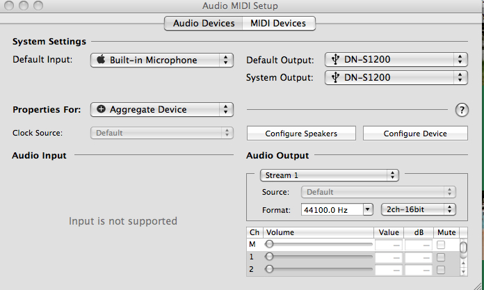

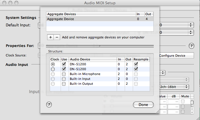

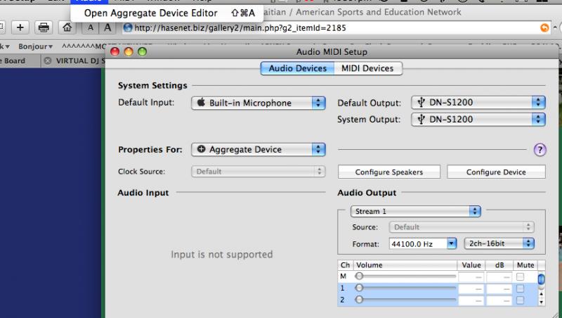

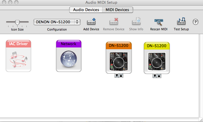

Feb 12 2009 DENON DN-S1200 setup with Virtual DJ Config
Mac Setup For Beat Matching and Scratching
1.Cue Mode -------> Denon
2.Auto Cue--------->-54 dB
3.CFade Level------>-54dB
4.NFile CFade------->3sec
5.S-Stroke---------->Short For Best Scratching
6.3/4 Effect--------->ON
7.Jump Time------->10 sec
8.Pitch Range------>+&-16%
9.EOM Time--------->15 sec
10.Fader Mode------>2L P/Cue
11.Pitch--------------->Key AdjON
12.Play Mode--------->Single
13.TIME Mode-------->Remain
14.TT Tricks----------->ON
15.Audio Curve------->ON
16.Search Step-------->1step
17.Playback------------>File
18.File Search--------->Artist
19.BPM Range-------->+&-10
20.Power On Play---->Off
21.Relay Play---------->On
22.Region-------------->USA
23.KB Type------------->English(US)
24.MIDI CH SET------->1 & 2
25.JogTrns Int-------->1ms for Mac & XP 10 ms for Vista For Best Scratching
26.Unit No Set-------->All
Today on 12-14-09 Topic is How to set up Virtual DJ and DN-S1200 to have to different type of mixes:
1. Using Pitch On to mix which gives a better beat matching
2. Using Pitch/Key to mix which gives one better treble on the intro song to mix with the actual song playing.
1. turn on the DN-S1200 let it boot up, when it\\\\\\\\\\\\\\\' s done. Hold Memo down to enter Preset mode.
Turn parameter knob until the display reads Pitch (not Pitch Range)
Press down on the parameter knob and then turn it until the display reads Key AdjON
Press the Parameter knob down again
Press Memo to save. Repeat these steps for both players.

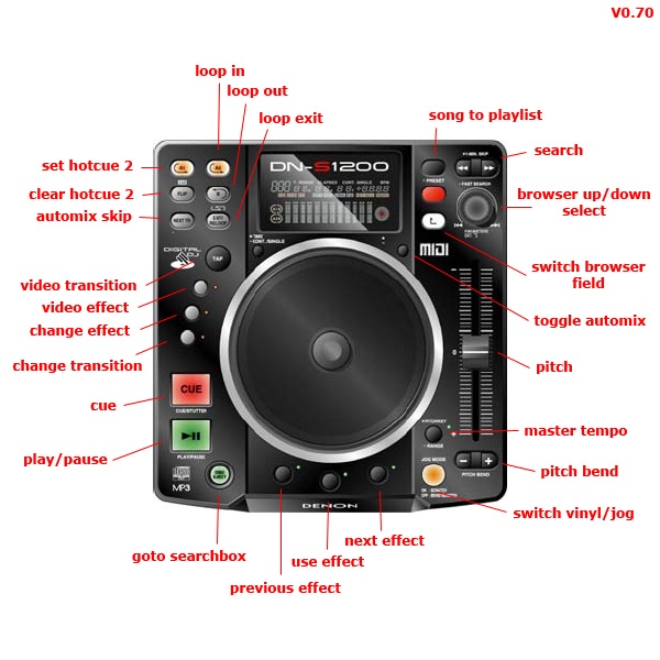

DJ Mixing Method for using DJ Modernsound DNS1200 mapper
http://www.virtualdj.com/addons/4820/Denon_DN-S1200_midi_mapper.html
1--load the first song and press the cue button to start the first song from the pre-programmed cue button
2--with either the cross fader on the side with the active song playing or the cross fader in the middle with the active deck channel fader up and the song being cued on the other deck with the channel fader all the way down.
3--With headphone on load the other deck with the song planned to be mixed into.
4--press the Echo/Loop button to Synch the Cue song with the actual song being played on the PA system, and press the A2 button.
5--Now you are ready to play the cued song with the fader still being down, hit the cue button at this point.---(if song is not totally synch either hit the Echo/lop button to automatically synch the two songs together or hit the cue button again several times til you get the 2 songs to synch.
5--At this point you may choose to count either 4 beat in your head or 8 or 16 beat and hit the B button to loop the Cued song (or the new song) you are about to mix into.
6--Using the eq button and other tricks your new song Is now playing. Do not forget to either turn down the channel fader of the old song that you are fading out of or move the Cross fader all the way to the other side of the new song you are mixing into.
7---Press the Flanger button to bring the normal pitch of the button to Zero
8-- Follow the process again for another song!!

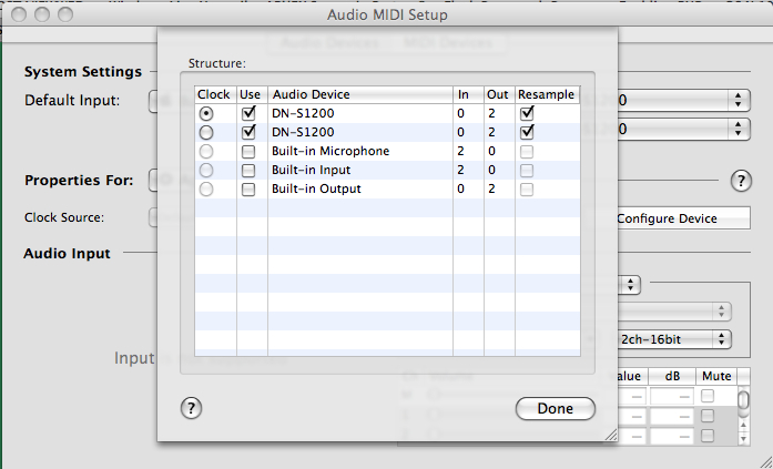

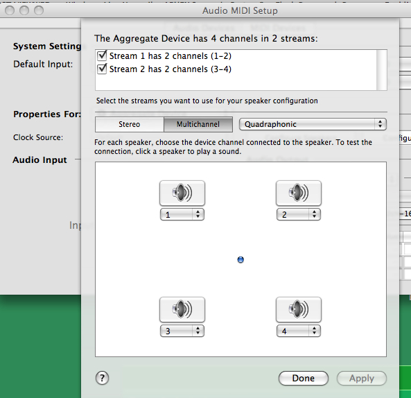

Two Soundcard Output Settups for Denon DN-S1200
Tue 15 May 07 @ 4:09 am
DJ MODERNSOUND
I put a little visual pictures of how to settup Denon DN-S1200, Denon Mixer DNX120, and Virtual DJ Mac version 5.0.8.
I had so much trouble finding out how to set them up, luckily I found the help of one our fellow Virtual DJ board member who led me In the right direction.
To settup Virtual DJ Mac and Denon DN-S1200 soundcards with DNX120 mixer you need to create an aggregate.
http://www.apple.com/pro/techniques/aggregateaudio/
If you click on the pic you will see exactly how to set up both soundcard for virtual DJ Mac. Good luck!
