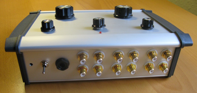

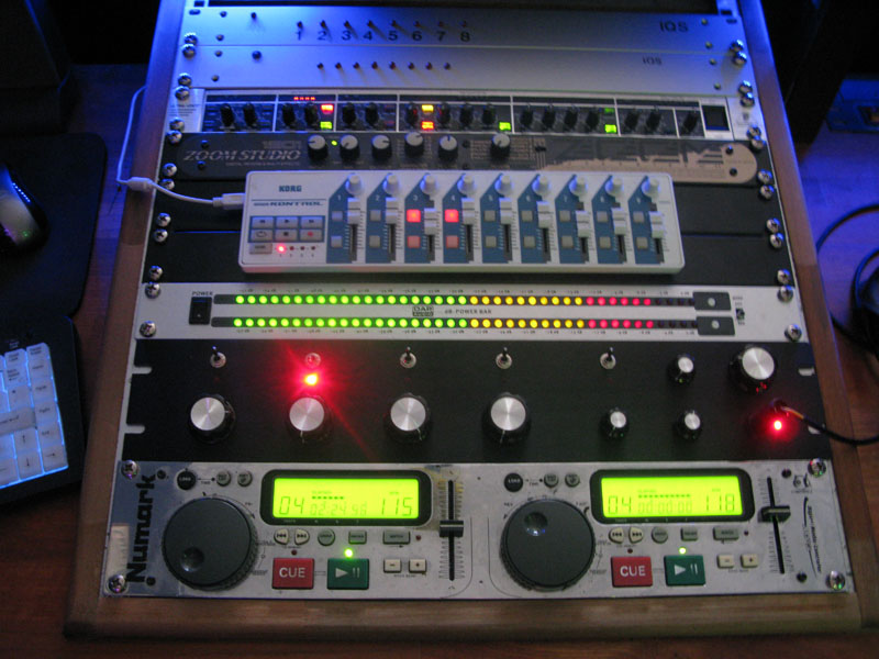

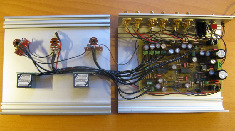

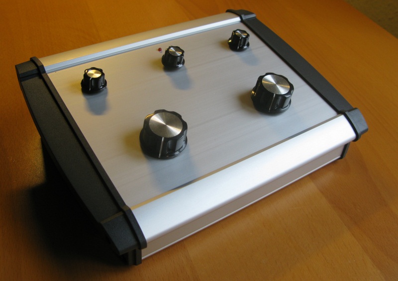

I created this mixer since i wanted a really small 2 ch mixer to be used with VDj and and a laptop since my 4ch 19 inch is a little to large to carry sometimes. Its done as an DIY project so that others can build it also.
Functionality:
- 2 Ch mixer.
- FX Loop.
- Cue - Master Headphone Blend.
- Tape Out.
- Master Out (unbalanced).
Potentiometer functionality:
Headphone Vol - CUE Blend - Master Vol
Ch 1 Vol - Ch 2 Vol
More info about it is on my website and FaceBook page
http://www.bozure.com
http://www.facebook.com/Bozure

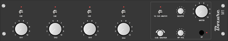

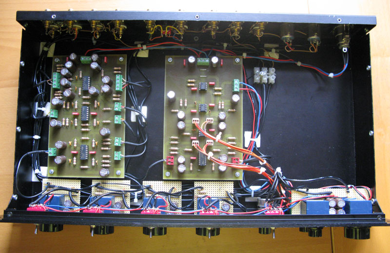

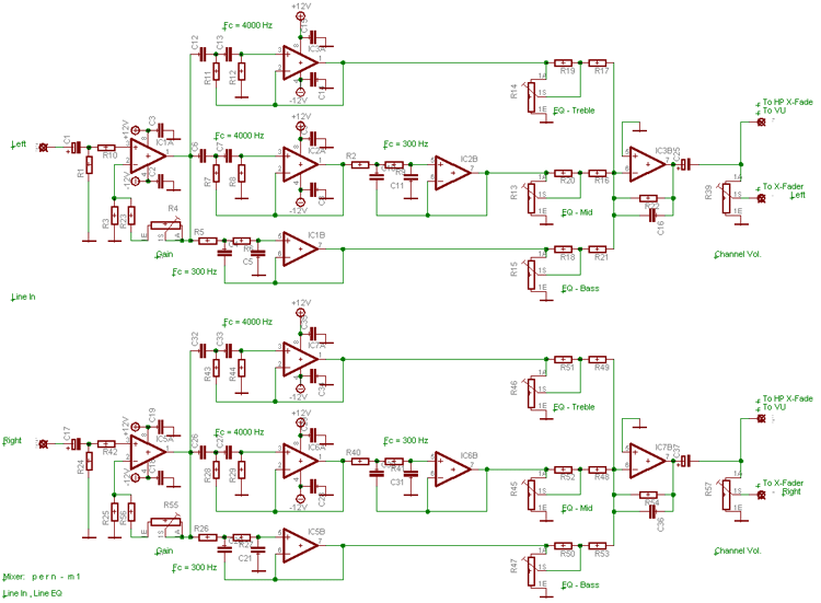

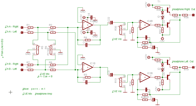

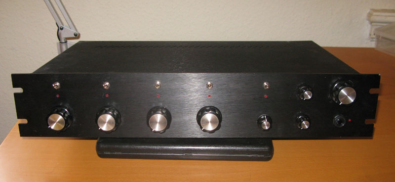

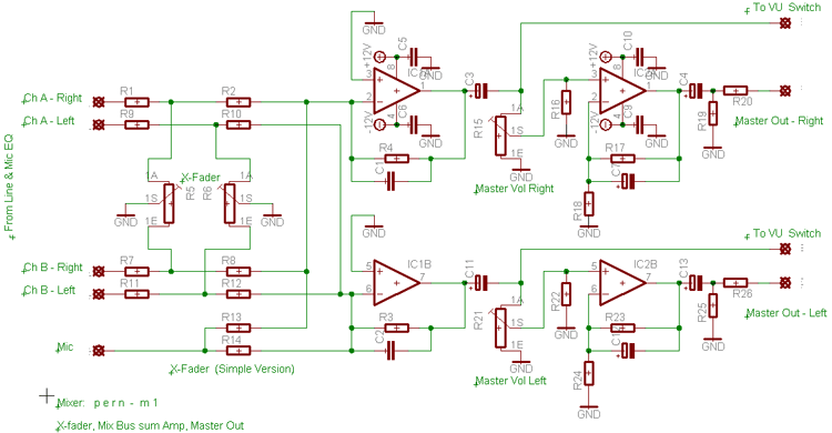

Just finished my new DIY Rotary Mixer.
Functionality:
- Can be used as a 2 Ch - 6 Ch mixer.
- FX Loop.
- Tape out.
- VU Out.
- Booth Out (unbalanced).
- Master Out (balanced).
Components:
- OP: TL074/TL072, NE5532.
- Caps: ELNA Silmic II, WIMA.
- Resistors: Carbon Film.
- Pots: ALPS RK27
Internal wiring: Mogami
It's done as an DIY project so that others can build it also.
The reason for the veroboards is so that it can be used in any enclosure 19 inch, desktop etc. And use any brand and models of pots and switches.
Here is the functionality:
http://www.bozure.com/T0.aspx?PID=5
http://www.facebook.com/pages/Bozure/148264061894553

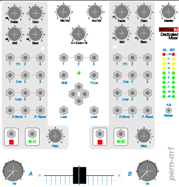

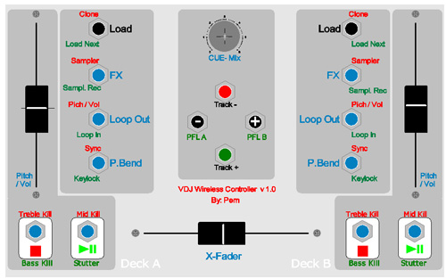

I actually started to look into this a while ago but never finished it.
The idea is to use a 2.4 Ghz wireless GamePad as a base, take it out of the box. Put in a new hand-held box and also add small external Antennas to boost the range.
With better antennas i think the range should be more than ok.
And to write a special mapper to handle all off this.
This is my first functionality design for that, note that most buttons have up to 3 functions
Maybee i should finish it.

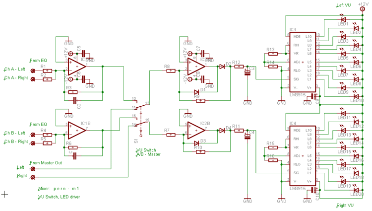

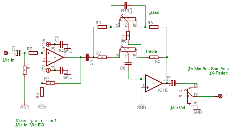

Here are the schematics for the pern-m1 mixer.
Line In (1 channel), Gain, 3-Band EQ with Rotary Kill, Channel Vol Fader.
Mic In, Mic EQ, Mic Vol
X-Fader (Simple Version), Master Out
CUE Mix, Headphone Amp
VU Switch , LED drivers etc
Fri 28 Apr 06 @ 9:56 am

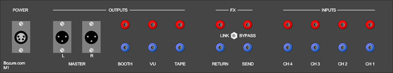

I have for a long time now been looking for the perfect small pro mixer
to use with VDJ, my laptop and my HDJC. But still haven't found any i like.
Sure, there are some small and "cheap" mixers out there. But they never
have the features i want. Today i use a Gemini 10" mixer and i think it's
a little to big to carry around.
BTW: You really don't need the HDJC to use it ;-)
So i finally decided to build my own VDJ dedicated mixer to get just what
i want in features etc.
Features:
- Really small (160mm * 160mm * 30mm)
- 4 assignable line inputs
- 3 band EQ with rotary kill
- Mixable Cue function
- A/B - Master selectable VU
- Mic EQ
- Buttons to controll all important features in VDJ
- Cheap to build ( $99 for material goal ).
- Etc.
Since i don't use the Crossfader a lot i will do 2 different X-fader designs
to choose from:
- Standard, simple one ( Can be removed ).
- Advanced with reverse switch, contour function etc ( On Front panel ).
I have just finished the front panel design and are now working
to finalize the schematics. ( CUE Vol is on the front )
And yes, i will share schematics etc later if anyone wants them.
More info about this project will be added soon.
Update #1:
Button bank select function makes all buttons have 2 functions.
22 User def buttons available now.
