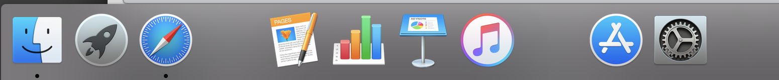

Launch the Terminal app.
At the Terminal prompt type this:
defaults write com.apple.dock persistent-apps -array-add '{"tile-type"="spacer-tile";}'; killall Dock
Your Dock will reboot with a single space added to it. Click and drag the space to your desired location, just like a regular app icon.
Repeat the Terminal command above to insert additional spaces and arrange them in your Dock to suit.
To remove a space from your Dock simply right-click (or Ctrl-click) it and select Remove from Dock. Alternatively, click and drag the space out of the Dock then let go of the mouse button to delete it.

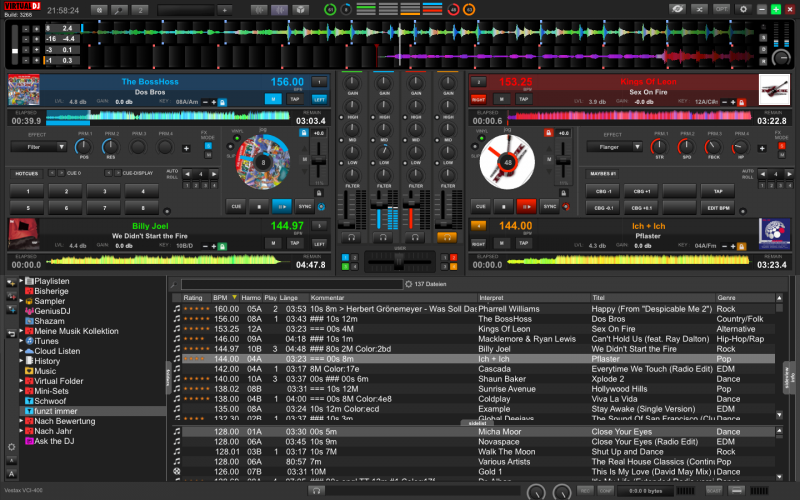

So, and this is how it looks:

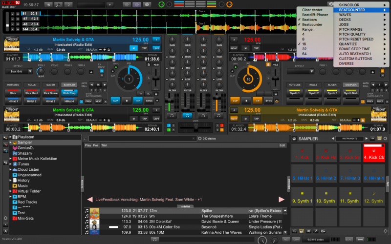

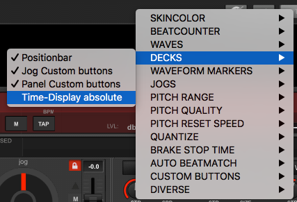

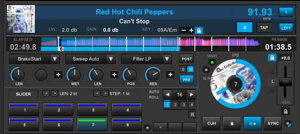

Version 1.2a is out now:
New features/adds:
  • buttons to select post/pre-fader fx
  • different waveform beat-markers added
  • visual for loop added
  • loop move buttons added
  • sample record button added
  • three custom-buttons for each deck added
  • video-override buttons added
  • fix: selected options will be saved and comes up by restart
  • fix: rewrite code for "new" browser_zoom action, so this should work with factory-defaults mapping
  • fix: battery status for mac now working
This thing is designed for VDJ 8.2.
Download:
http://www.virtualdj.com/plugins/index.html?search=The+thing
Comments are welcome:
http://www.virtualdj.com/forums/210456/addons/The_Thing.html?page=1

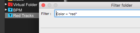

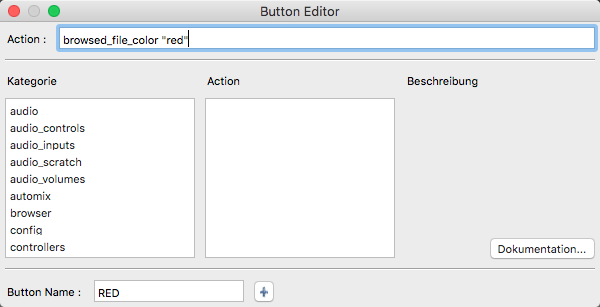

custom-buttons / keyboard-mapping:
browsed_file_color "red"
browsed_file_color "yellow"
browsed_file_color "green"
browsed_file_color "blue"
reset color:
browsed_file_color "reset"
Nach der Arbeit der Zuweisungen können die Files einfach via VDJ Filterfolder gefiltert werden
(English: after done the work you can easily filter your files with VDJ filterfolder):

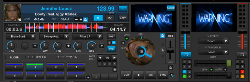

the button:
device_side 'left' ? saved_loop 1 ? var '$shift' ? loop_delete 1 : saved_loop_prepare 1 : loop ? saved_loop 1 : nothing : device_side 'right' ? saved_loop 4 ? var '$shift' ? loop_delete 4 : saved_loop_prepare 4 : loop ? saved_loop 4 : nothing : nothing
and the led:
device_side 'left' ? loop_load 1 ? loop_load_prepare 1 ? param_smaller loop_position 0 ? blink 250ms : blink : on : off : device_side 'right' ? loop_load 4 ? loop_load_prepare 4 ? param_smaller loop_position 0 ? blink 250ms : blink : on : off

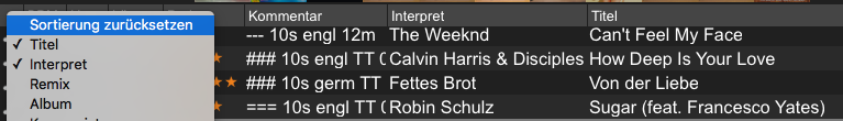

Um die ursprüngliche Sortierreihenfolge einer Playliste wieder herzustellen, klicke auf das 1. Kästchen in den Spaltenüberschriften:
Danach Sortierung zurücksetzen auswählen. Done ;o)
To restore the sort order of a playlist, click on the first square in your browser and select reset sort order. Done ;o)

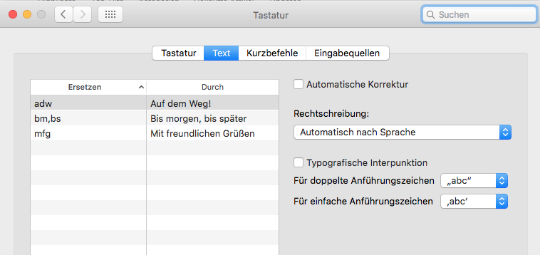

Weil mir diese "Eingabe-Hilfe" schon mehr als ein posting versemmelt hat, habe ich sie abgeschaltet:
Vorgehensweise:
- Klicke auf das Apple-Icon in der Menü-Leiste und wähle "Systemeinstellungen…"
- In der zweiten Reihe Tastatur anklicken.
- Reiter Text auswählen.
- Häkchen bei Automatische Korrektur und bei Typografische Interpunktion entfernen.
Sollte somit dann so aussehen:
Danach werden "falsche" Wörter nur unterstrichen und nicht mehr ersetzt.

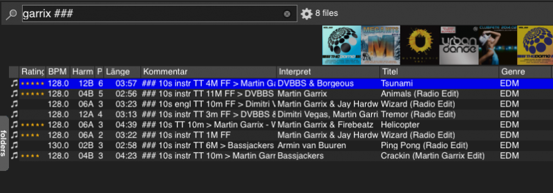

Trotz Genre und Bewertung steht man oft vor dem Problem, bestimmte Songs blitzschnell in der Sammlung zu finden. Ich bin daher dazu übergegangen, verschiedene Sonderzeichen im Kommentar zu verwenden.
Verwendung finden:
--- für Vorprogramm/Warm-Up
=== für Main-Time
### für Peak/Auf die Ohren
<!> Moderationstitel/Spiele & Animation
<<< Starters/Intros
Hier und da werden die Sonderzeichen auch in Kombination verwendet:
=<! built up / Tempowechsel / Genre-Wechsel
=>! built down / Tempowechsel / Genre-Wechsel
Diese Sonderzeichen stehen bei mir immer an 1. Stelle im Kommentar. Da VDJ auch im Kommentar sucht, werden die gewünschten Titel schnell gefunden:

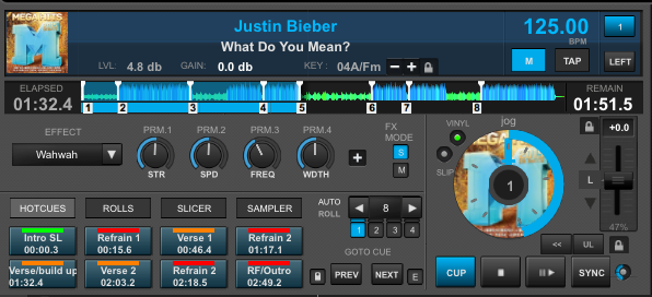

Falls man ein reminder im skin setzen will, findet folgendes script Anwendung:
action="songpos_remain 15000ms ? blink 400ms : songpos_remain 30000ms ? blink : off"
Da der Stand.-Skin von VDJ leider nur die Zeitanzeige blinken lässt, unternimmt man folgende Änderungen (nachfolgende Angabe beziehen sich auf den Standard 2Deck skin (2 Decks.xml).
