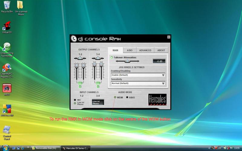

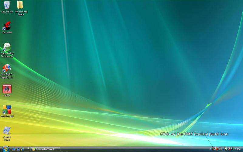

Connect the RMX to your Laptop/PC then open the RMX control Panel up.
Once the Control Panel is opened you then can change the mode in which the RMX can be ran in, WDM or ASIO. To run in WDM mode please do as described.

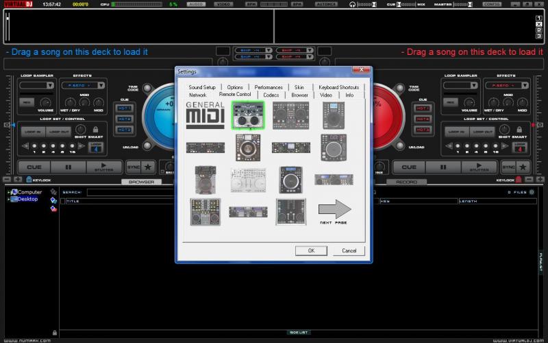

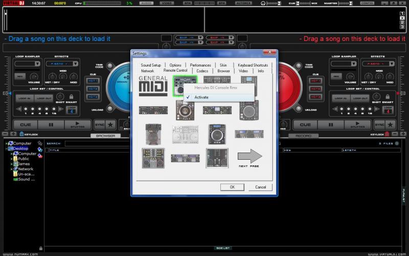

Launch VirtaulDJ and head straight to the Config. Open it up and click on the Remote Control Tab. To choose the RMX in the Remote control Tab, please click on the MK2 Icon.
If the RMX is activated it should be highlighted in Green, if it is not the it will be highlighted Red

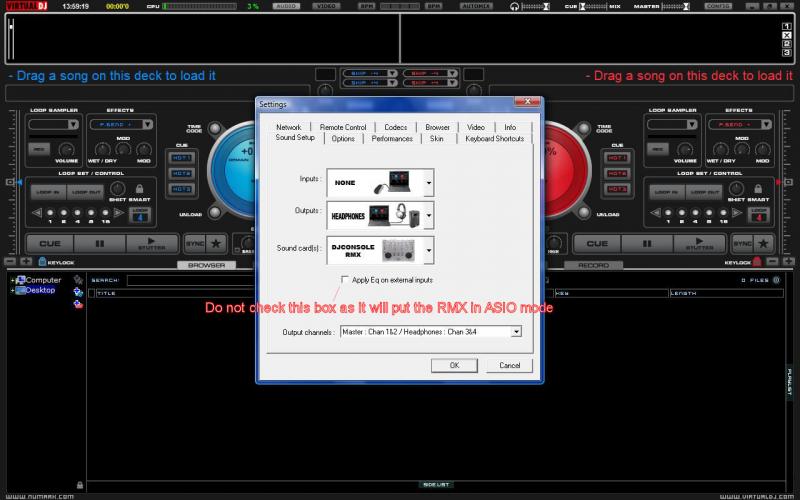

Move to the Sound Setup Tab and set as descirbed

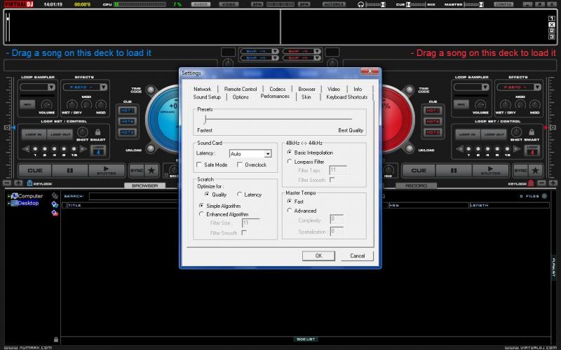

Once the Sound Setup is done move to the Preformance Tab. Many people have sound issues, here is where you can experiment to try and sort at these issues out, 90% of the time you can solve them here, if not then you must look deeper into it.
As a general guide, these setting (which I run on) are a good starting point.
Please note, each Laptop/PC is different so if these setting do not work for you then you will have to experiment with other factors.
