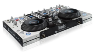

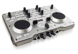

DJ Console MK2, DJConsole Mk4 DJConsole 4-Mx
Portable, twin deck DJ mixer with audio customized to play, mix and create DJ music on a PC or a Mac.
All sound card configurations that work on a RMX or MK2 may should also work in MK4, so if you don't find MK4 configuration, you can view MK2 to configure in the same way the sound card. The only exception is in the back switch in MK4 that allow you to connect high gain CD players like CDJ Pioneer line.

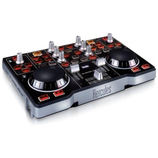

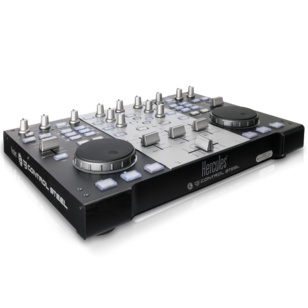

DJ Control MP3, MP3 e2 & Control Steel
Dual deck DJ Mix Controller. 2 decks to load 2 music files as if you had 2 turntables
Portable DJ Mix Controller (235x200x65mm). Plugging DJ Control to your laptop makes a mobile beat DJ machine
High precision wheels and buttons for DJ mixing. DJing is easier with real DJControl than with a mouse or a keyboard
* Play one song while preparing the next one
* Fade gradually from one song to another with the crossfader, so that the music don’t stop
* Synchronize two songs with the Auto-Beat and Master Tempo buttons
User-friendly mixing solution. Customized version of VirtualDJ® 3, a powerful and intuitive software. DJ Control MP3 makes mixing instinctive.
Sound Card Configuration
DJ Control MP3, e2 and Steel has no Sound cards included, and you may need a 4.0 or better sound card available in your computer to work with MASTER+HEADPHONES use.
There are some notes to correctly setup your sound card to be use by this controllers without sound card:
First of all, is that you need a 4.0 sound card (2 separate or more individual stereo outputs).
Second, this sound card must be your default sound card in your OS setup. This is important, LE version of this consoles just can be route to default sound card, there is no second card operation available (and it's better to use only one sound card. 2 Sound card operation is ONLY available with VirtualDJ Pro for DJConsole use).
So with only one sound card 4.0 or better you are ready to go with your DJControl or Steel Console.
It is important to set your OS to work with 4.0 (quadraphonic) or better speaker system (even if you only use it in stereo). So in Windows you need to go to CONTROL PANEL --- SOUND and in ADVANCED SPEAKERS select Quadraphonic or 5.1 surround sound system. In Mac OS, just go to Finder--APPs--Utilities-Audio/Midi and configure to be used in Quadraphonic environment.
Now You can go to VirtualDJ LE and mix with MASTER+HEADPHONES (or also MIXER 2 Line Out using VirtualDJ Pro).
That's all, enjoy!.
