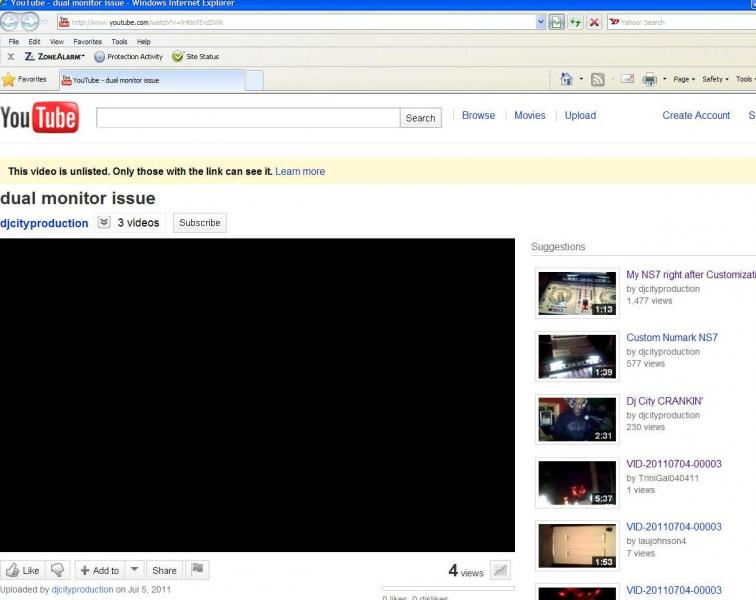

I can't see your youtube video for some reason....
geposted Wed 06 Jul 11 @ 8:16 pm
The link should work. I tried it and was able to view the video. Try again.
geposted Wed 06 Jul 11 @ 8:27 pm
This is all I get when I click the link you provided..
geposted Wed 06 Jul 11 @ 8:36 pm
