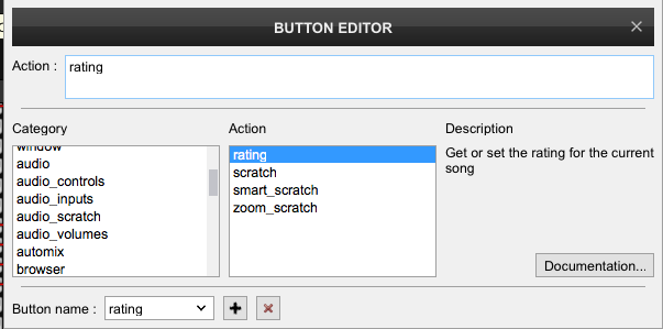

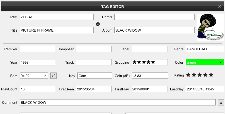

Is there a way or is there a specific string for the button editor to 'set rating' ⭐⭐⭐⭐⭐ to files
instead of going to the tag editor

I don't know what you use on your keyboard for shortcuts, but you could assign Shift+1 (through 5) to this.
rating 1
rating 2
rating 3
rating 4
rating 5
When the song is playing or in the deck, press Shift+1(-5) and it'll set the rating for that track to the corresponding number.
I'm not sure how to do it where you can select the track in the browser to set it or to cycle through the ratings 1 at a time.
I wish "rating +1" or "cycle rating 5" worked. Maybe someone smarter can help.
Those above could also be set to custom buttons.

Thanks Cannen, it worked.
