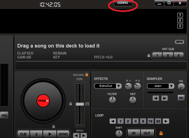

Open up the software and go to Config then sound setup

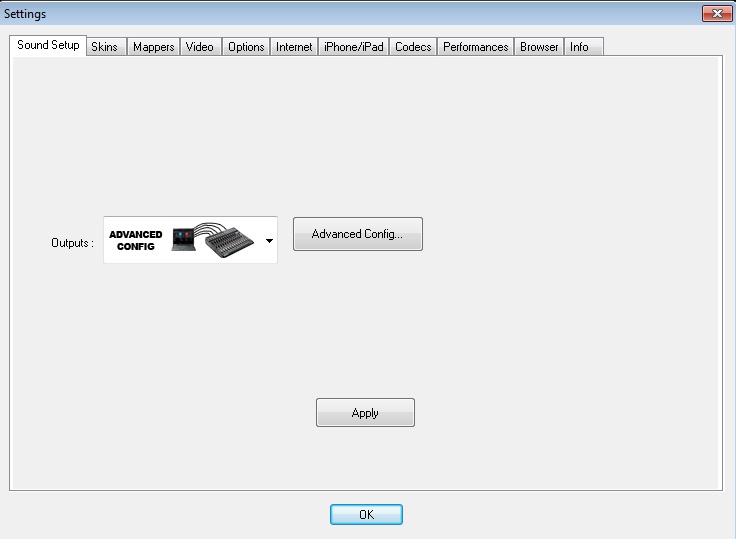

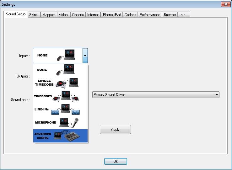

In the sound setup tab under inputs choose Advanced
Then click on the Advanced Config button

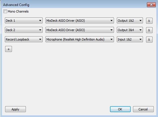

Now setup your decks according to the following image. Your record loopback setting should be set to your primary sound card (not necessarily the one captured in the image).
Note: Your input line may need to be switched from input 1&2 to input 3&4 in the record loopback setting depending on how your computers inputs are configured. Make a test recording to see if your settings are correct - if you have no sound in your recording, switch the inputs.
