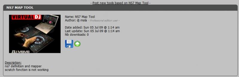

I have just upload the map of the NS7 on vdj tools with using your link !
NS7.jpg" class="bb-img">
thanks
thanks
geposted Sat 04 Jul 09 @ 6:20 pm

v1.1 is here
NS7_Def___Mapper.html" target="_blank" rel="nofollow">http://www.virtualdj.com/addons/8508/NS7_Def___Mapper.html
geposted Mon 06 Jul 09 @ 6:40 am

I just add new element in the map :
load file on deck 1 & 2
control of the song on platter to make it slower or faster , and in pause mode you can know positionning your song for cue point !
fader reverse fixed
and i'm working on fader start it works but not correctly :
<map value="FADER_START_A" action="fader_start" />
<map value="FADER_START_B" action="fader_start" />
if someone has ideas ...
The update map is avalaible on vdj dowloads tools : NS7 def and map v1.2
thanks
