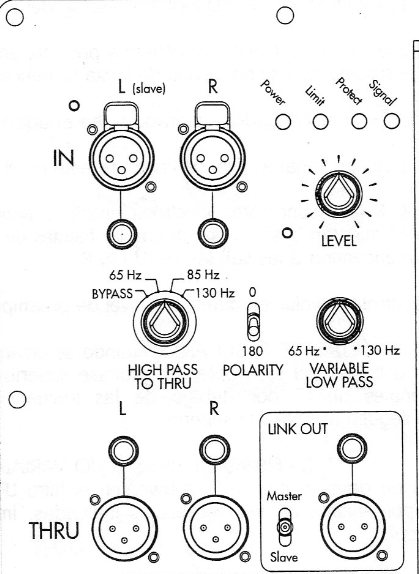

oks here we go...
my PA Sub model is the Cerwin Vega cva-118 and i have 2 pa speakers.. heres the pic...
1.- The high pass is adjustable for 65, 85, 130 hz, and bypass only
2.- The low pass can be adjustable in a range from 65 to 130 hz, (not exact numbers in the range... is open)
3.- How to know if the 180 o 0 switch is better.
4.- master/slave... the info is in the pic..
thks agian my frien
geposted Sun 29 Nov 09 @ 2:07 pm
heres a better pic
geposted Sun 29 Nov 09 @ 2:13 pm
geposted Sun 29 Nov 09 @ 2:16 pm
Ok
You should be connected in the following way. Main out 1 and 2 on the Motu 1 gives you Left and 2 gives you Right. These should be connected to the L and R IN on the Sub.
each of your PA speakers should be connected to the L and R thru connections on the Sub.
Master/slave select to------master
low pass to around the center point in the range
High pass to--------65Hz
Polarity to------------0 (to start with. If you find that you hear more bass when set to 180 then thats fine. It will depend on where the sub is positioned relative to the PA speakers) you can use your ears for this. There should be a noticable difference if the switch is moved so just use whatever position works best.
