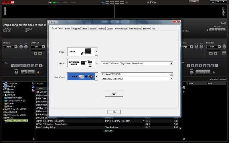

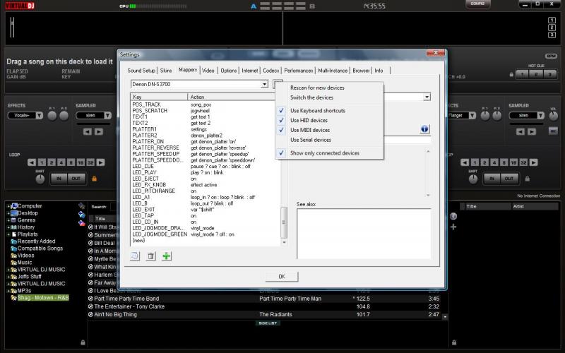

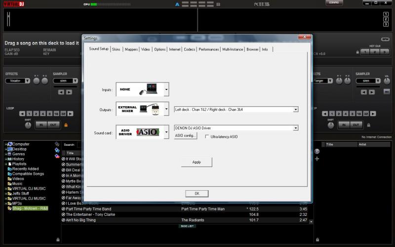

Ok, here are the screenshots. I am providing two of the audio since I tried both ways.
geposted Sun 06 Jun 10 @ 1:40 pm
-Must use v1330 Only.
-first image is correct> Sound Card > Denon DJ ASIO (2nd image is wrong)
-Vista is a terrible OS for all MIDI controllers, upgrade to Win7
-You will need to wait until VDJ gets to your ticket, this is a computer conflict somwhere with VDJ.

A wonderful working response from the team here at VDJ:
Message: First on the mapper tab, go to the bottom left button and reset the mapper back to the defaults.
If that doesn't correct the issue, then go to the Info tab and reset the software to factory default settings. Will need to reset your Audio and Performance settings after that. Then if that still doesn't solve the issue.
There is something screwy with your install ... uninstall the software, download a fresh install from your Download Center and then install again.
I reset the mapper back to factory settings, and she works!!!!!!! Thank you VDJ support team!!!!
