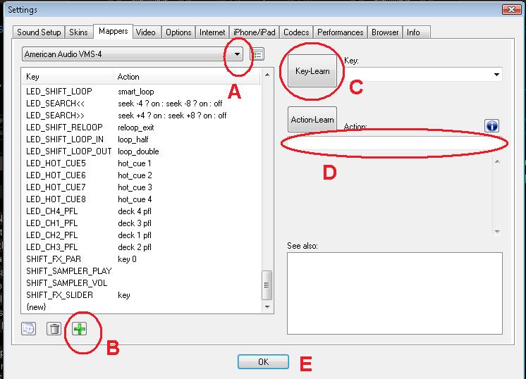

First I gonna try the firstr solution, but how ?
I use the keyboard mapper ?
I put in the key-learn field "CTRL+A"
and what now, where I have to put the commands ?
And what is the correct text (underscores, etc ???)
Thanks for your help.

A. Choose a controller or keyboard to assign an action (shortcut)
B. Choose to add.
C. Key Learn will be selected, so all you have to do is press the button you wish to asign.
D. Write the script code (action).. for example ... deck 1 pfl
Repeat B, C, D, until you finished with adding, then ..
E. Press OK
