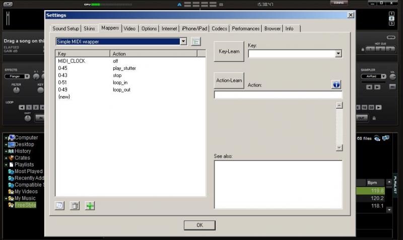

Im not necessarily a newbie to Dj'ing however i am new to mapping and the setup process. I am looking to mapp 2 midi controllers.
First is the X1600.
I have the plug in that i downloaded and executed. I can see it in under the mappers tab in config. When its plugged in usb and under the midi devices it shows (keyboard)(numark v'7)(and i think it said simple midi mapper). However there were only 4,5 commands listed in it. But if i open the xml file of it in my doc' plugins ,mapp etc it does show i guess 25 commands. Any help or if there is another topic that covers it and you can share that link that would be great. I should mention that i do have the denon and V7's both plugged in USB and can work the audio via usb and not line in. I can use the effects thru the v7's but cant utilize the midi function and parameters on the denon.

If your DN-X1600 mappings don't work, make sure you have the latest version (currently 7.0.2). For some reason DN-X1600 MIDI-mappings won't work with earlier version. Also, make sure your mapper file and mixer settings both have the same MIDI-channel.
Here's my DN-X1600 mapper for example:
My mixer is set to use MIDI-channel 1, thus all value-parameters are "1-XX".

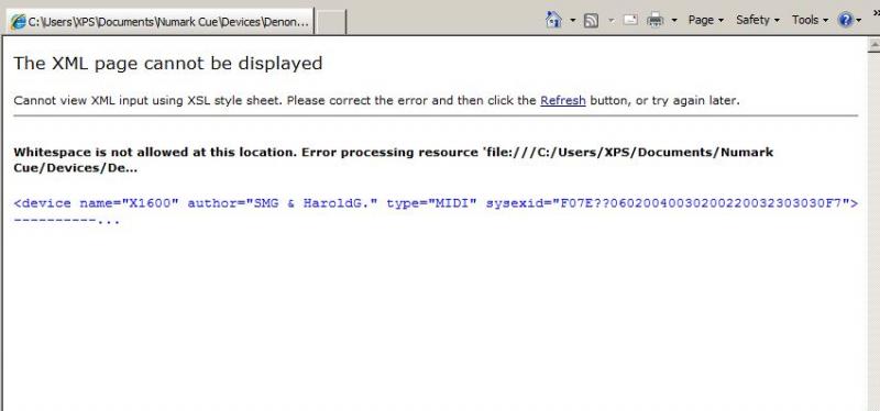

YOU ARE 100% right Hu,
I was able to use both the KORG and the Denon at the same time for midi.. what i realized, i do not have any definition file or mapping file for SIMPLE_MIDI wrapper and the definition file that is downloadable from the plugins, or addons is incomplete. if u can send me that definition & mapping file that would be sweet.. heres the definition xml file from the denon x1600 from that exe file

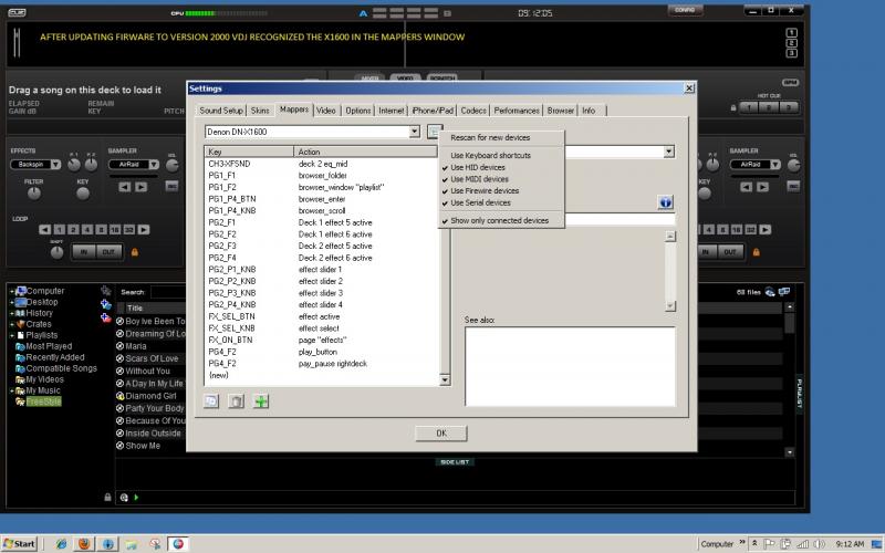

well for starters the absolute FIRST THING TO DO is to update firmware tO CURRENT VERSION 2000, without the update vdj only sees the x1600 as SIMPLE MIDI WRAPPER, after update it recognizes it as actual connected device as denon dn-x1600
