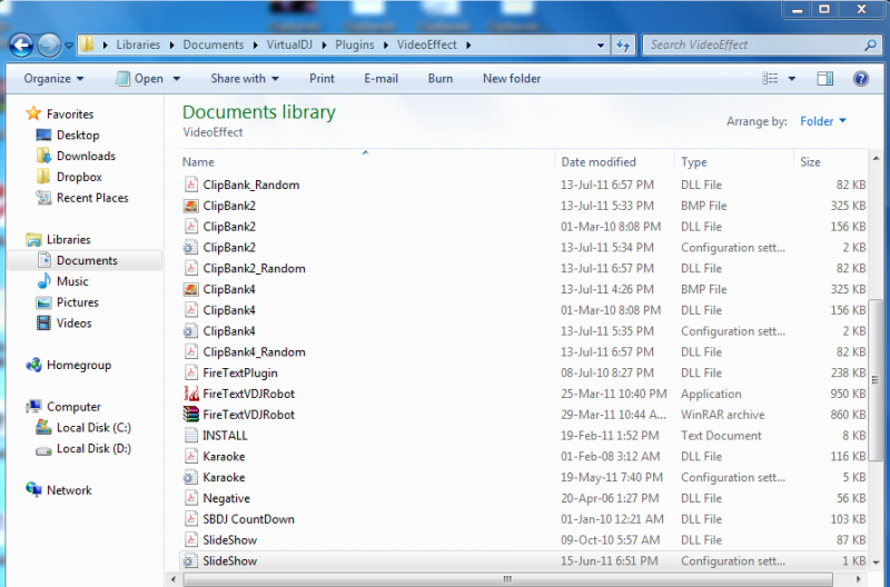

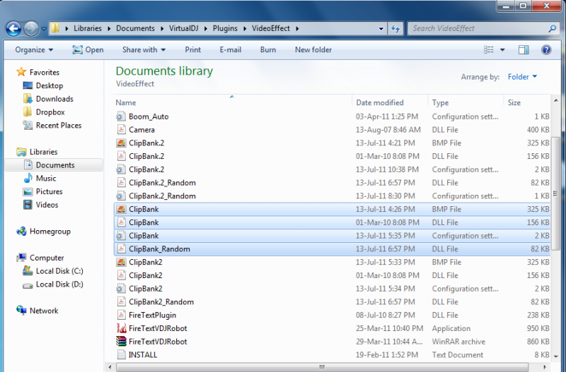

as you can see in the image (just) clipbank.2 and clipbank.2_random are working fine, but if i tried to use the other clipbank2 without the fullstop in it it would not work with either of the other clipbank_random effects

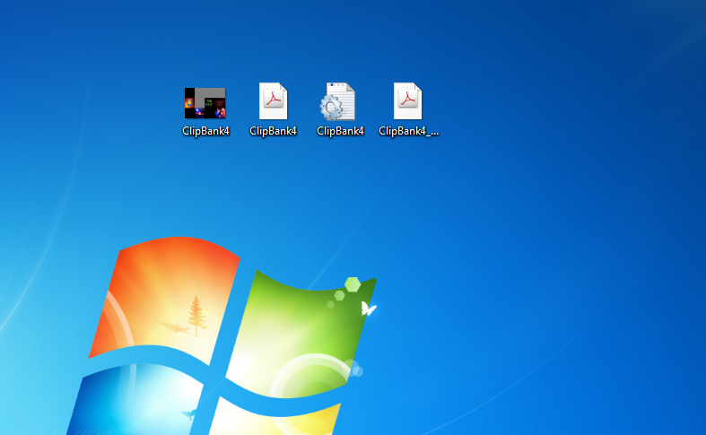

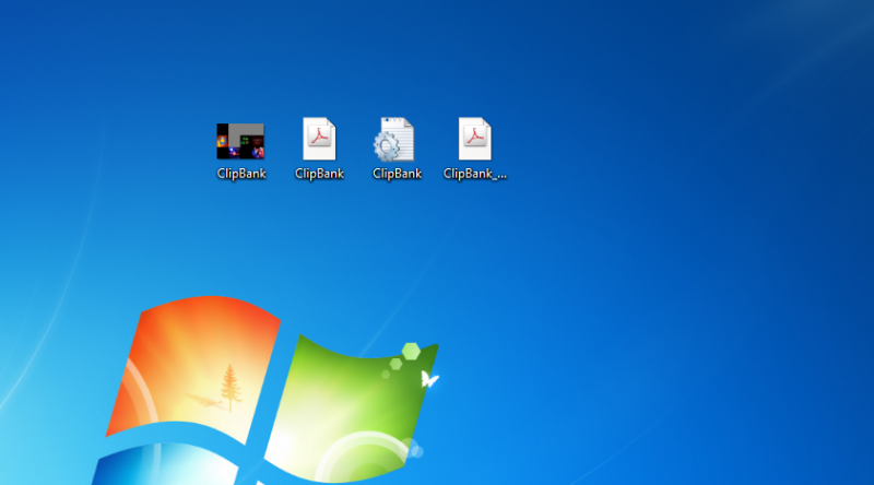

For those of you that can't be bothered to go through the thread and are still having problems, here's what I do to get multiple named clipbanks to work with the "randomizer".... make sure VDJ is closed.
1/ go to your documents > VDJ > plugins > video effects and highlight the original clipbank.dll - pdf and bmp file you will also need to highlight the original clipbank_random as well.
2/ copy and paste these to your desk top or anywhere that is convenient for you...
3/ rename each one eaxactly the same name of your choosing, I just selected the number 4 for ease of use for this tutorial,
4/ copy and paste those newly named four files back into the original folder...
use the files on your desk top if you need more clipbanks just simply rename them again and follow the above proceedure

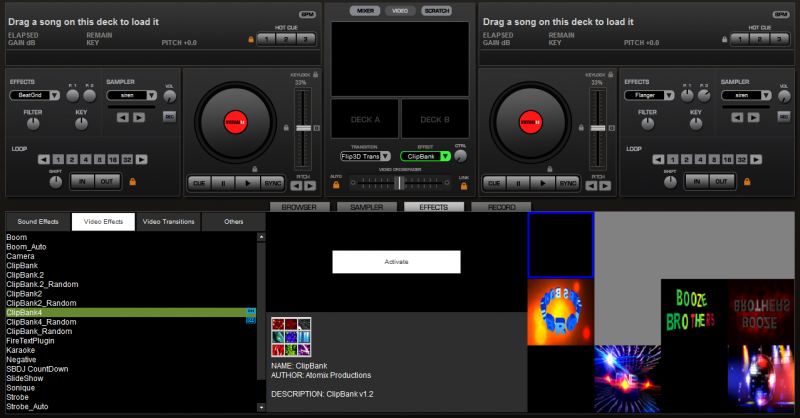

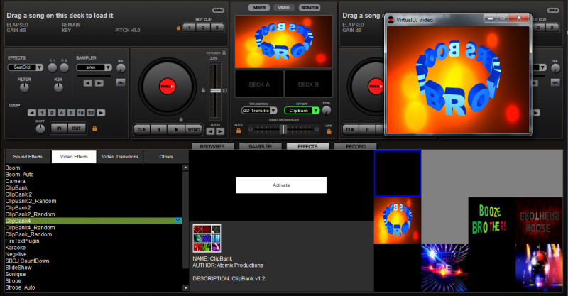

5/ open up VDJ > video effects and go to your new clipbank file highlight and activate, load your new clips and deactivate...
6/ now firstly, highlight your new clipbank_random and activate, then highlight your new corresponding clipbank and activate..
to swap to new clipbanks deactive current clipbank plugins then select your new ones and activate in the same order as above.
follow the above and there will be no need to shut down VDJ to open new clipbanks.
hope that helps.
