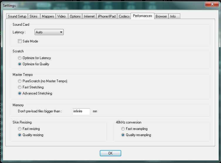

I did a half hour test tonight, ASIO mode is still a no go for me just creates a ton of noise with any larency setting. The good news is that the general sound quality has improved but still I feel it could be better, probably due to the resampling (48khz). Interestingly I had no issues with 2ms latency using WDM.

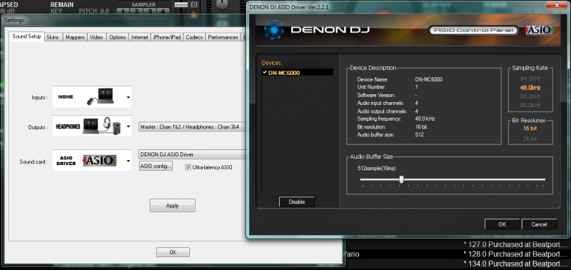

I have finally managed to get the MC-6000 to work perfectly in Asio mode 2 deck external (VDJ 7.2)
48Khz conversion in the VDJ performances settings is set at Quality Resampling, and I have ultra-latency Asio ticked in the sound settings.
Did a 4 hour gig on Saturday night and it ran perfectly.

I've had those crackles on rare ocassions, when it happens I just move the ASIO AUDIO BUFFER 1 or 2 notches to the left or right. The default is 512ms of buffer. Notice I'm using ASIO v2.2.1
Some other users have had luck by lowering their graphics hardware acceleration, in Windows 7 I believe u have to disable Aero to gain access to the accelerator slider.
If your laptop is exclusively for VDJ, do yourself a favor, do a fresh install of Windows and only load your video, audio and chipset drivers (download their latest versions before hand). For the rest of the other devices you may have to either use the built-in windows drivers or disable them.
If you get those crackles, for trobleshooting purposes, disable all possible devices in the Device Manager, such as NICs, Webcams, other USB devices, Bluetooth, Wireless Video, etc. See if the crackles go away, if they do, then you'll have a pretty good idea of what caused them.
