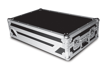

When I pre-ordered my NS7 II at the AC Dj Expo - I received a free tshirt and also a free case. Well when the unit shipped the case was a week behind, but I finally got it yesterday. I though I was getting a soft case...nope I go a road ready hard case. Cannot be happier!
