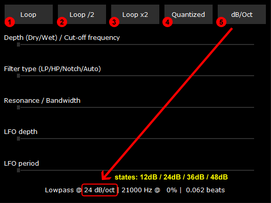

I'm trying to control a virtual button within an effect with a hardware button through VDJscript. See the following image:
The following script works fine for the five sliders: deck [X] effect 'Filters_v2_TexZK' slider [Y].
So I thought the same approach would work as well for the five buttons: deck [X] effect 'Filters_v2_TexZK' button [Y].
But when I try this script on button 5 (dB/Oct), nothing happens.
In this case button 5 is not a toggle button, but a kind of cycle button. With every click a parameter changes value according to a predefined list with values. In this case the following list: [12, 24, 36, 38].

The only action you can use is the effect_button , but this wont help what you are after.
I would suggest to rename the effect (the dll file) and have multiple copies of that,(e.g. effectname001, effectname002.dll etc) each one with the value that you need the 5th button to have.

Thanks for you answer.
Is this effect_button the same thing I tried in my example script or something different? And if so, how does that work?
Do you mean the buttons inside an effect can't be controlled at all, or will my toggle/skip idea just not work?
I might try that copy DLL trick. It would have been easier if that control had been a slider.
