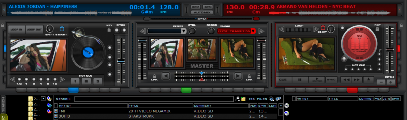

Talking about skins, one of the things I miss from VDJ7 was the multi-tabbed approach Matt used in skins like Vmix 5.4
You could easily swap window view by clicking a tab and even have it different for each deck.
To date I don't think this skinning method has been used since.

Keith, the method you mentioned is just static panels and nothing has been changed in that. Its up to the skinners to go that way and provide skins that work similar to what that mentioned skin offers.
We are talking about Split panels, introduced in version 8 , kinda what you see in the Browser where the nested split panels can be resized on the fly. In the past i have tried to use those split panels in some skins, but it turned out not much useful. Its quite useful though if you want to create your own custom Browser.
