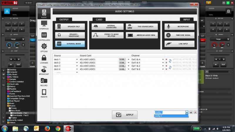

A picture of your audio config will help, and no you don't get V7 under a controller licence.

This is what I have - at the right hand bottom - there was the VMS 4.1 option, but I think I deleted that by mistake.

Is your VMS4 on 4out or 8out mode ?
If its on 8out mode, then the above Sound setup should work and the middle MIDILOGS should control deck 1 and 2.
If its in 4out mode, then you should change the Audio setup as deck 1 Ch 1&2 and deck 2 Ch 3&4, since it only offers 4outs and not 8.
Btw, you dont have to use the 4out mode, unless you need the Inputs for Timecodes.

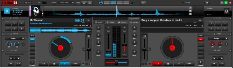

As you can see - Deck A's playing through Channel 3...
geposted Mon 06 Apr 15 @ 6:14 am
Thanks djdad - switched the channels for deck 1 and 2 and it seems to be working on! Sweet!
