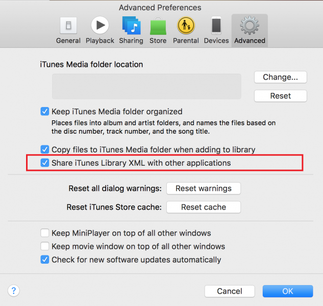

VirtualDJ uses the itunes Library.xml file to read your itunes database. In itunes 12, this xml file is not shared by default and may cause your itunes library to not be read by VDJ.
To correct this go to Preferences>Advanced and insure that share itunes Library xml with other applications is checked.
itunes.jpg" class="bb-img">
After this, close itunes completely. It will generate the xml file required by VirtualDJ and you will then be able to launch the software to have complete access to your itunes Library.
