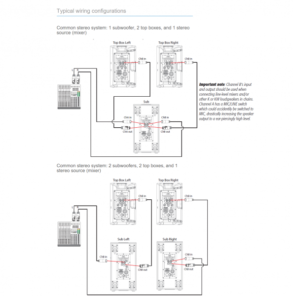

Now got 2 x QSC k12 and 2 x QSC KW 181 running with gains at 12 and K12's set to external sub (when subs used) Looking for a 3rd K12 as a backup now
geposted Mon 07 Dec 15 @ 10:51 pm
Are you going to the subs first?
geposted Mon 07 Dec 15 @ 10:55 pm
Yes i go from mixer to subs, then subs to tops.
