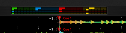

This one will pass by with everyone until you have notice it at the right time.
I think it is just related to SS#3.
Anyway, here are pictures of it.
To test: While playing a song, perfectly time it to pause exactly when it hits the red mark. You will notice that it will stay there and not clears up (falls down).
Even loading a new song to the deck, that red mark stays there until of course you press play.
See that first screen shot. I timed that song on both deck to pause on the red mark.
The second screen shot is when I loaded a different song and the red mark stays.
geposted Tue 01 Nov 16 @ 2:00 am
Trust me, I know this "bug" but it's not related to the skin itself...
Perhaps I can do some work-around to eliminate it if that's so much of a big deal...
Background technical details:
The RED bar shows the limiter. In this photo case it shows the limiter of the particular deck.
The problem is that as soon as you stop the deck, there are a few rare cases that the "get_limiter" action can stuck to the last reported value until you do anything on the deck that may produce noise (and thus force the vu-meters to recalculate themselves).
geposted Tue 01 Nov 16 @ 11:39 am
