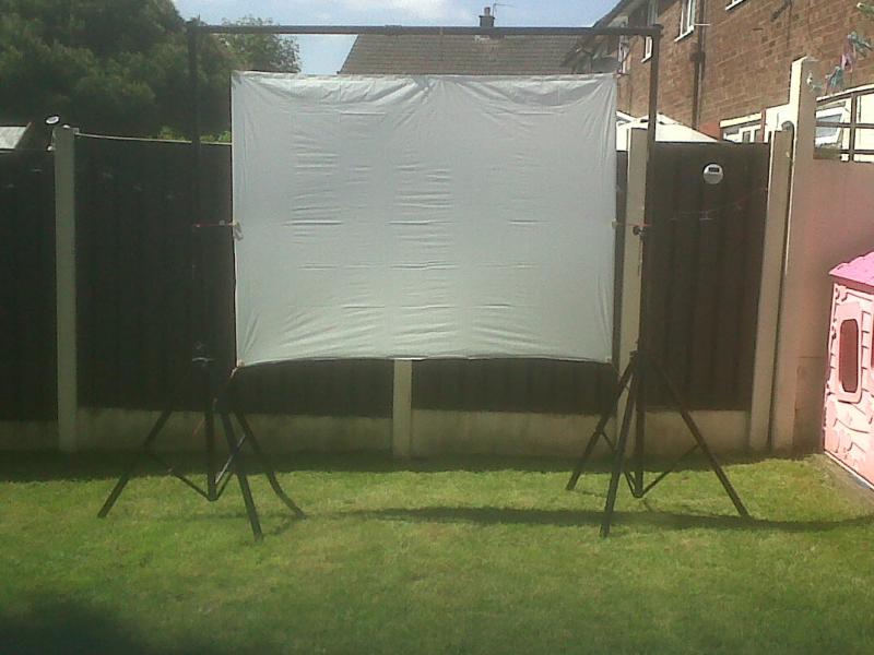

OK, so I've gone up market to the Asda (Walmart) plain white 100% peva shower curtain liner, it cost £4.
It's slightly stronger than the Argos curtain, produces a good rear projection image, and resists the dreaded hotspot..which I have now seen on an Ikea curtain. There are recommended methods for removing creases included in the instruction. Many have used this curtain successfully according to internet posts.

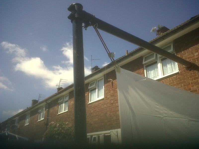

I now seem to have a plan to hang the curtain.
With a 40mm dia. 7ft. long black waste pipe as a cross member, I then used the eyes on the curtain, and cable ties to secure it to this pipe. A 90 degree elbow is glued on each end of the pipe which then enables it to sit on the upright poles of my two light stands.
I've not decided as yet whether to cut the bottom of the curtain off or just leave it as a skirt.
We shall see..

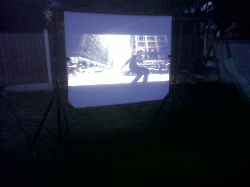

It's hanging in my bedroom in front of a window.
I've been out in the street and seen the rear projection image, it looks good.
It will be next week before I can offer the next episode.
I need to set it up in a proper venue.

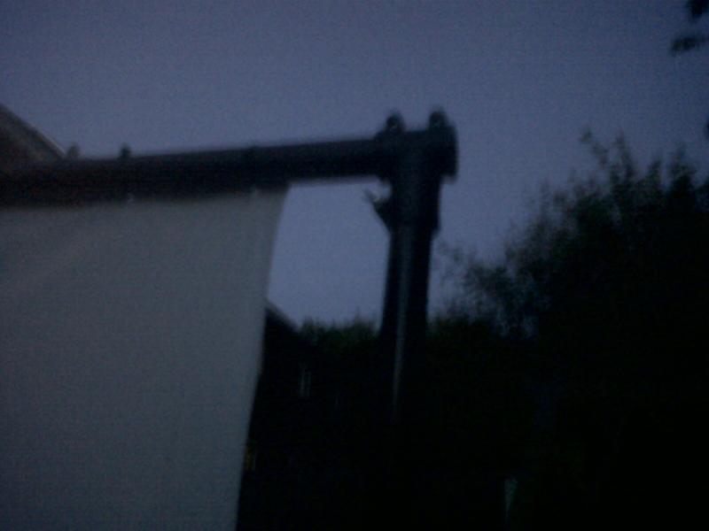

The Asda shower curtain did not perform that well.
I hit two problems, the creases are stubborn, and the rear projection image is only equal to the front in terms of brightness.

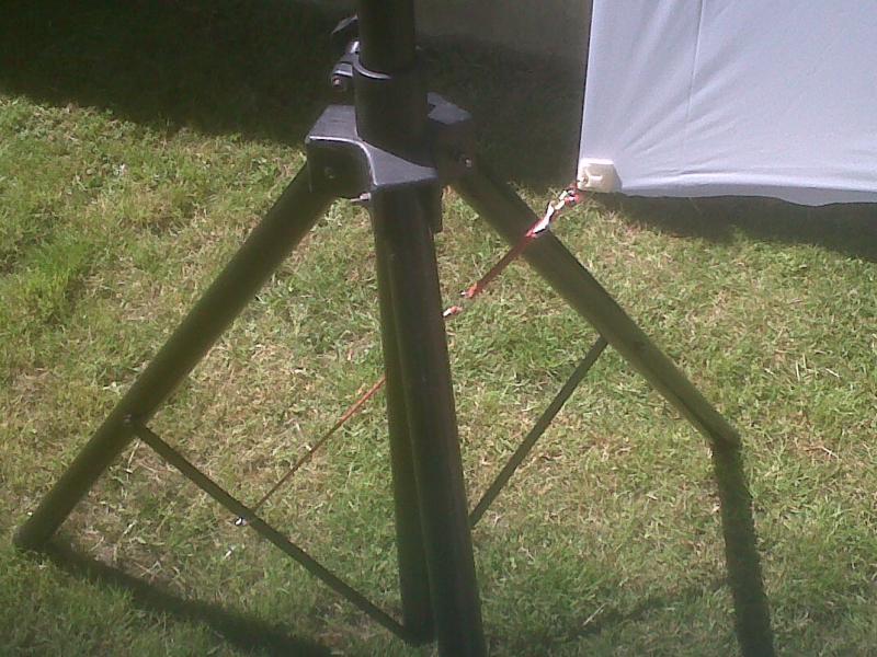

This drove me back to the Argos shower curtain which is fragile, but optically almost perfect.

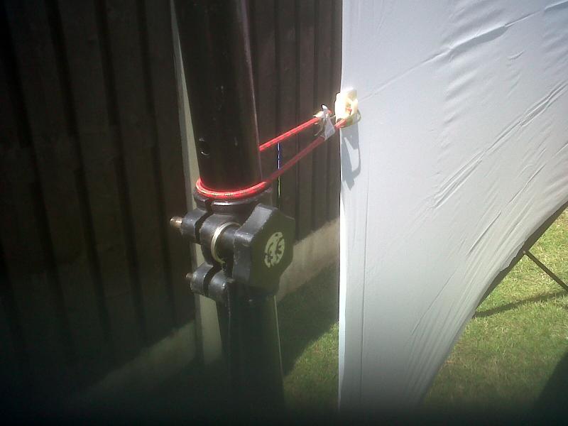

As in one of the photographs I posted five point support using bungee cords is my latest set up.
Support points: top right, left and center plus left and right on the bottom.
I can do this without installing eyelets, but I will fit them in an attempt to achieve a more professional look.

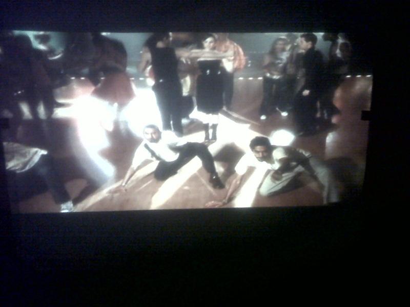

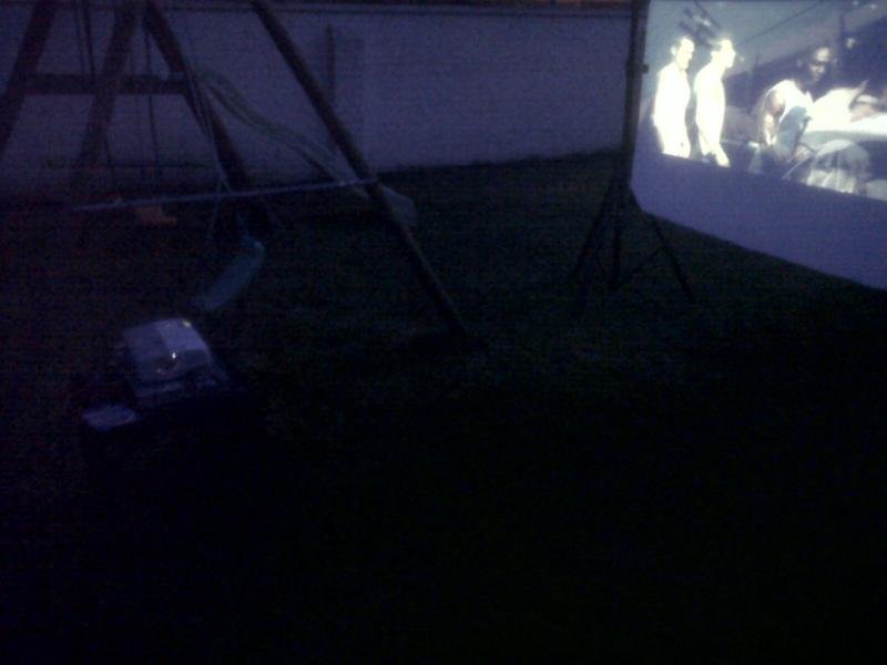

Here are some of the photographs which made me decide to use the Argos curtain rather than Asda.
Notice that there is no sign of a hotspot.
The hotspot would be by the foot of the central dancer in photograph 5, directly below the singer.
The Asda shower curtain would do at a push..but I want better.
You can see where I've used black gaffa tape to reinforce the shower curtain while I await the arrival of my eyelet machine.
I do keep changing my mind....and I hope to get my spandex screen in the post tomorrow. I'll let you know how that goes.

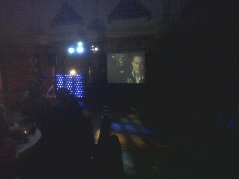

The Asda (Walmart) shower curtain is better than the Argos equivalent. Using the Asda curtain the hotspot is totally removed, whilst the Argos one permits a faint glow. Also the Asda shower curtain is more robust, and the colours seem more vivid.
Anyway it's going to work tonight, as opposed to being tested.

The Asda shower curtain in action.
In my normal frenzy setting up I tore out one of the brass eyelets.
Fortunately I had a simple solution.
http://www.diy.com/departments/bq-white-20mm-self-adhesive-cable-mounts-pack-of-50/177951_BQ.prd?gclid=CNHBuNuZgs0CFUa4Gwodi1MJvw&ppc_type=shopping&ecamp=SEAPLA177951_BQ&ef_id=Vv7mYQAAAauFOAhS:20160530161830:s
One on either side of the damaged curtain with the bungee cable hooks on both sides so as to eliminate twisting.
This is a second floor one man setup.

I've given up putting eyelets in the screen, this is my latest effort.
I'm going back to the Argos curtain since it's brighter, even though there is a faint glow due to the hotspot effect.
I'll have to see if I can get some proper rear projection material to test.
Note: My stands where blew over totally twice today, yet no harm was done!
