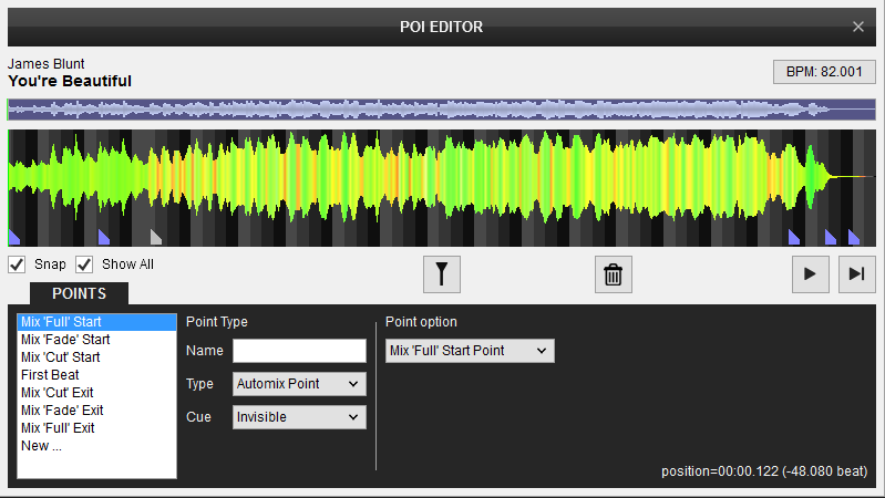

Anyone notice that Fade Start and Exit points have gone missing in the new builds? Had a ton set and they appear to be gone.
Pretty much all other set points appear to still be there.

Like MixFadeStart and MixFadeExit?
Mine appears to still be there (when I click "show all")
I'm on the newest public build (b3734)

3760 here. Lots, if not all, of previously Fade Start and Fade Exits have been erased.

Are the poi erased, or just moved?
It looks like the fade points will indeed be recalculated even when set manually, this will be fixed in next build.
In the meantime you can go back to the current stable build until the update is available

They appear to be gone entirely.
I'll roll back and check.
geposted Thu 01 Jun 17 @ 5:50 pm
Rolled back to 3734. Still missing. How far back should I go?

best way to avoid issues is NOT to use early access updates on your Gig Machine :-)
you will probably need to re-scan the tracks with it missing is my guess

have you re-scanned a track to see if they come back?
if they are actually removed i can see no other way for them to come back
also i do not have this issue with the latest early access build maybe a mac issue?
geposted Thu 01 Jun 17 @ 9:52 pm
Re-scanned them all. No luck.
All files back up on CrashPlan so I can roll back the database if needed.
geposted Thu 01 Jun 17 @ 9:55 pm
Going back to the current public build will stop it from removing the points from other songs you loaded.
The ones already loaded in current early access will already have been overwritten
It's still strange that they would be gone rather than overwritten though, can't get that to happen here

Haha. Can I roll the database back and recover?
geposted Fri 02 Jun 17 @ 5:10 am
Yes kf course, if you revert your database.xml to your backup copy you will have your points back as well
