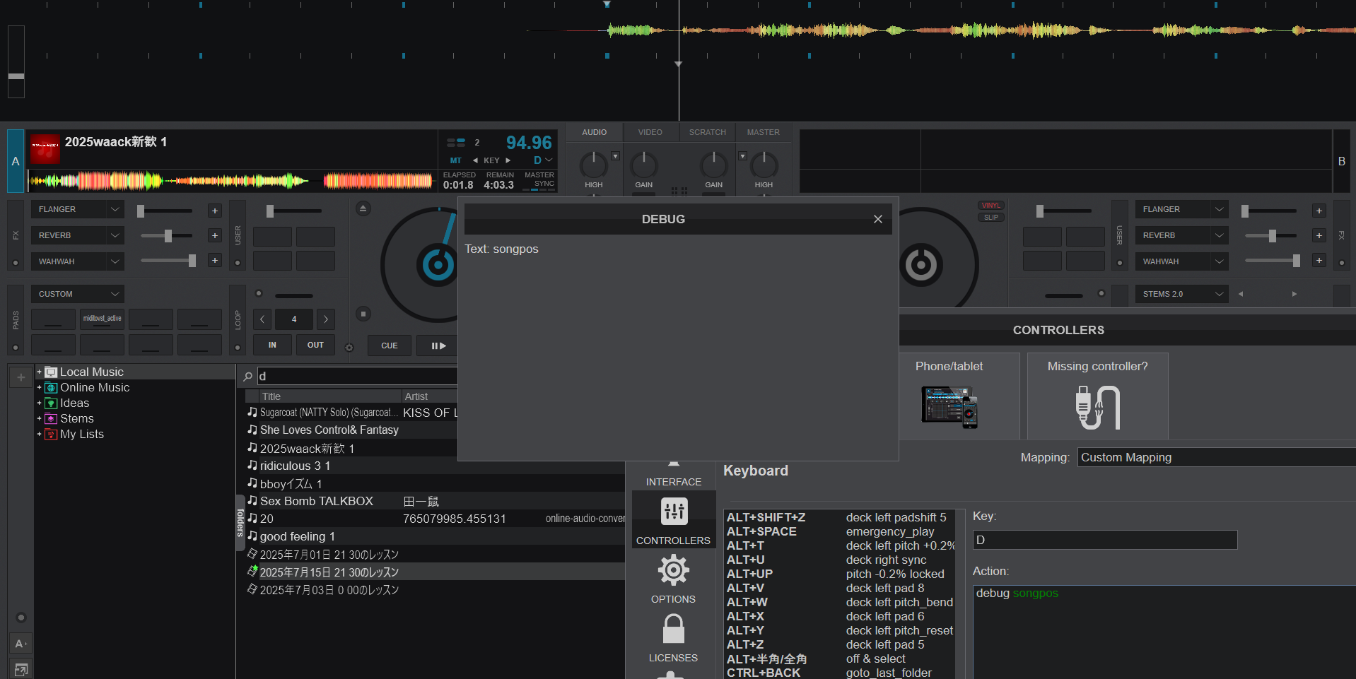

I tried debug songpos to check the current position in VirtualDJ, but it only shows a window with the word "songpos."
Is there a way to show the actual value?
geposted Tue 22 Jul 25 @ 6:05 am
For a start it's song_pos not songpos.
And the syntax for debug is
GetThing & param_cast & debug
geposted Tue 22 Jul 25 @ 6:26 am

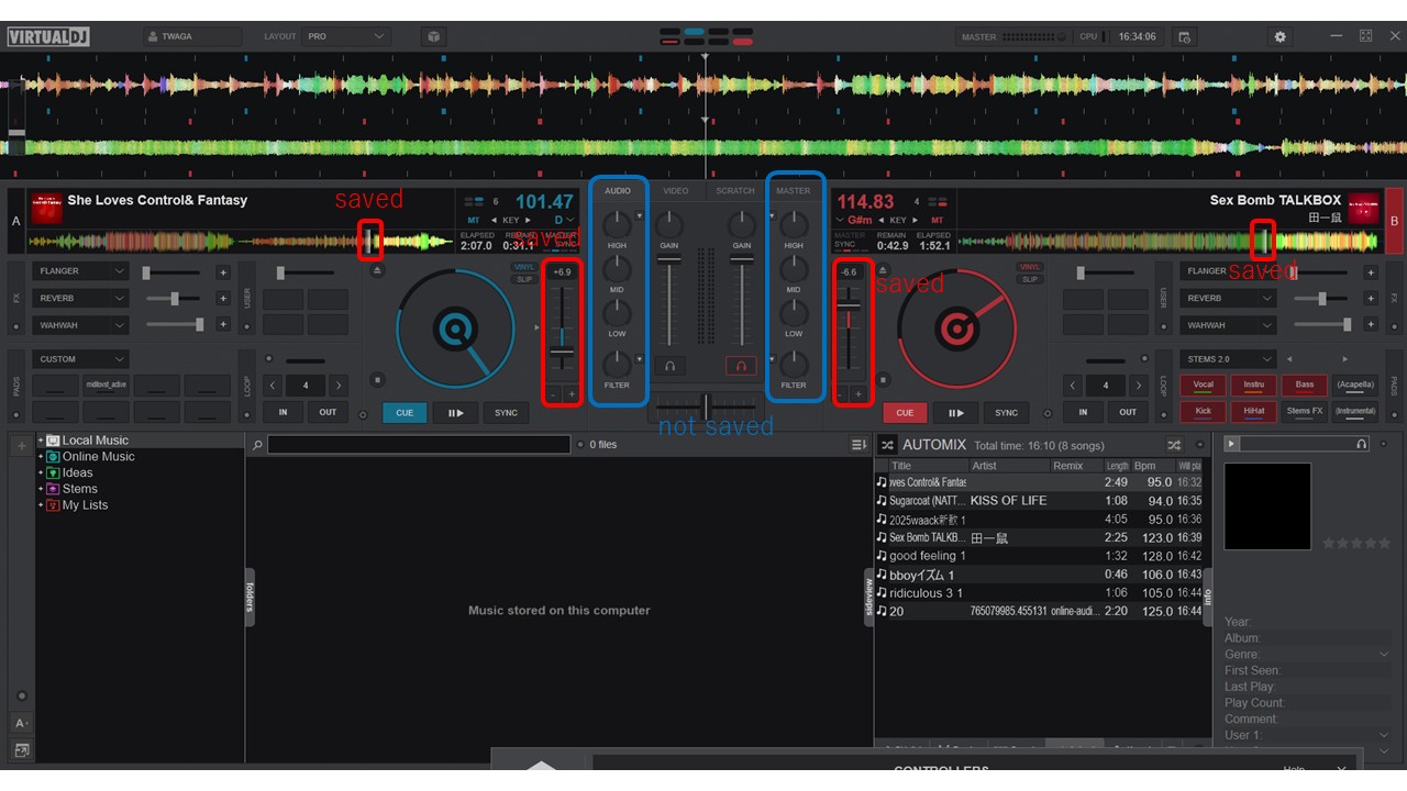

For the past few years, I've been creating long DJ mixes—sometimes lasting up to 10 hours—over the course of several days. When I stop for the day, I pause the mix and take a picture of my screen with my phone so I can remember the exact playback position and settings. The next day, I manually restore the decks to the same position and settings based on the photo. After finishing the full mix, I use video editing software to cut out any silent parts between sessions.
Ideally, I’d like to develop a plugin (or request a feature) that lets me save the current session state—including the playhead position, pitch, and EQ values of both decks—and then resume exactly where I left off the next day.
Ultimately, I’d like to develop a plugin that has this kind of functionality.
geposted Tue 22 Jul 25 @ 7:16 am
Perhaps you can experiment with save_deck_set and load_deck_set then.
Also, you could set a "temporary" hotcue (let's say hotcue 99) on the position that you want to keep in memory, that you can delete afterwards (after you resume your working with the mix the next day)
So, instead of trying to seek to position 48.87% on the song (that would be what song_pos reports) you have a hotcue ready to take you there. And hotcues are virtually unlimited in VitualDJ. Therefore you don't have to "waste" a "good" slot (hotcues 1-8). You can decide to always use hotcue 99, or hotcue 20 or whatever number you want..
PS:
I have done what you do once or twice, and my way of doing things was quite simpler:
I made it a habit to always end my "partial" mix on a song with 0% pitch adjustment and flat EQ that would play until the end.
Then on the next session I would start mixing from the beginning of that same song and I would not adjust pitch / EQ until it was time to mix the next one.
Therefore, in post I would have plenty of "space" where both parts of my long mix would play the exact same part of a song with the exact same "settings". So it would be easy to "overlap" and mix cut them.

Thanks for your opinion and very helpful information!
I was able to save the pitch value and the pause point with save_the_deck. I'm satisfied with just that, but it couldn't save the EQ value. It would be great if the EQ value could also be saved.
geposted Tue 22 Jul 25 @ 7:40 am
The xml file saved by save_deck_set looks like this:
<deckset version="850" date="2025/07/22">
<load deck="1" filepath="xxx.wav" volume="4096" pos="5985252" gain="2048" pitch="4377"/>
<load deck="2" filepath="yyy.mp3" volume="4096" pos="4616170" gain="2048" pitch="3824"/>
</deckset>
I wonder if it is possible to specify high, mid, and low attributes in the load tag by editting this xml file manually.
geposted Tue 22 Jul 25 @ 1:57 pm
Probably not, as part of your save deck set procedure you could write a script to an unused tag and recall it next time round.
geposted Tue 22 Jul 25 @ 2:34 pm
