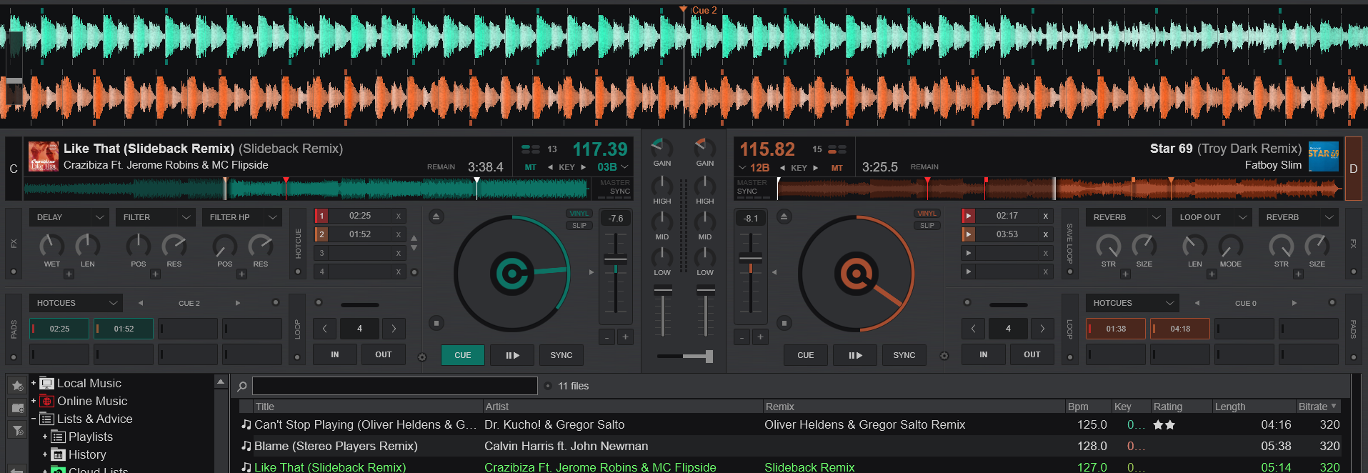

it's the deck X leftdeck from the controller command that is screwing it up rune.
I've tweaked the default skin so it only shows C&D for him to test

I'm not sure who's confused here, I know I am.
the ddj1k in question has 2 laptops connected to it, users want machine 1 to only control decks 1 & 2, machine 2 deck 3 & 4
because the 1k sends a invert_deck command when it does it's HW shift and the default skin 2 deck being left/right the dj in waiting will have 2 decks on screen that aren't his
maybe it doesn't need a skin tweak, maybe just a rsi,
no it'll need this removing also
<nbdecks value="2" condition="var_equal '@$4decks' 0"/>
geposted Thu 12 Mar 20 @ 7:37 pm

Went with the skin tweak, rsi forcing 'side'deck left a chance for things to go wrong,
made pro 1&2 and pro3&4, also did the same with performance
gmedia is testing but first reports are, 'all good'
geposted Sun 15 Mar 20 @ 3:39 pm
So far it is EXACTLY what I needed. I can have all 4 decks active and visible at once with never any "muted" decks. Since the DDJ-1000 only has two jog wheels (which is perfect for me as a mobile), you just need to press the one "deck change" button to toggle between A/C or 1/3 and B/D or 2/4. Otherwise, you can just use your mouse or touch screen and keep the jog wheels locked to A/C or 1/2.
