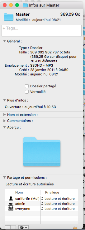

Super useful info. Thanks a lot. My question is if the setaitotag is eneble and I changed a bunch of tag from genre folk to genre 80, all seams to be ok. If I reloads the tag vdj reload the genre folk. Means he didn’t change it in the file like it supposed to. Do I lose a lot of songs because they are not in my filter because my filter is looking for genre 80 and now is genre folk.
geposted Thu 22 Aug 19 @ 9:09 pm
This means that the files most likely are read only (and therefore VirtualDJ can't modify their tags)
That's why the first thing I said is to check if the files are read only (and if VirtualDJ has read/write permissions on these files)
geposted Thu 22 Aug 19 @ 9:18 pm
Its working. Thank you. The read only wasn’t enable so I selected it and deselected it. Now it’s ok. Another simple question for you : when I links video with audio it create a new file. If I change the tag in the original audio file ore video file to keep just the new file I lose the new file. The old files are physically on the drive but not in my filter result so I lose everything. It’s like if the video edit needs those files in the same directory to work. Is there any way to see just the new video edit file? Now I need to keep 3 files to have one how combine the two. Thank you
geposted Fri 23 Aug 19 @ 2:10 am
