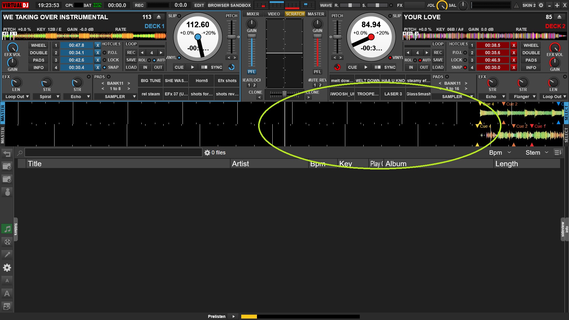

ok so here what im talking about i have highlighted the area in question dragging the wave form back to the start i end up in these horrific quiet zones (crickets chirping) i wanna know how to get rid of it ..
geposted Sat 15 Jul 23 @ 3:57 am

As it was already explained to you, that's NOT the normal or expected behavior.
In fact your jogs show that the track was deliberately moved backwards in time for about 30 seconds.
So, something on your workflow or scripts e.t.c. is completely wrong.
Keep a backup of your settings.xml file, delete it and start clean. Start with default skin and default controller mapping too.
Then keep adding things / changing them back to what you are used to until you find what causes this.
However, long story short: The program does what you tell it to do: Move the track backwards in negative time (before the start of the song)

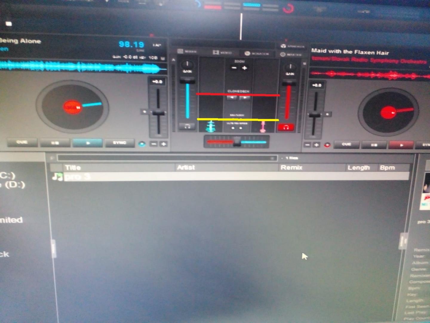

NO: Actually never explained or corrected so here im sending you a pic of a fresh install of vdj on another system with different tracks that have no silence to the start
geposted Fri 05 Dec 25 @ 3:48 pm

Could you explain why you are dragging the playhead beyond the start of the audible portion of the file?
Being able to do that is completely normal - Serato allows for that too.
VirtualDJ does not start with the play head from that section by default unless you changed something to make it load there - e.g. set a loadpoint there, or perhaps you are using Timecode in Smart mode and you put the needle down in the lead in part of the record.
If you want to guarantee load + starting in no silence, what @groovindj gave you is the answer
