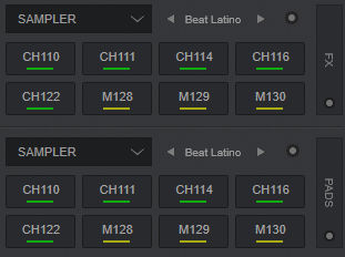

I was just playing around with the Pro skin (b7827) and I noticed something strange with the sampler...

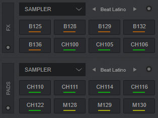

With the same panel options ticked on both decks, bringing up the sampler banks with 16 samples, on the left side I see all 16 - the first 8 in the FX area, and the second 8 below, in the pads area.
However, on the right (deck) side, I only see the 2nd bank of 8 repeated.

Indeed, the second deck will always start from sample 8 if there are more than 8 samples.
Currently the pads are all individually mapped, so it's a bit tricky to make the right side aware that the left side is showing 16 samples instead of 8.
I can probably fix it if sixteenPadsMode option is set to Yes, and alternatively you could also modify the sampler pad page to use sampler_pad 1 "4x4x2" instead of sampler_pad 1 "auto"

It's confusing because when set to 8 pads per side, it makes sense to have access to 9-16 on the right, as controllers generally have 8 pads per side - but when switching the skin to show 16 pads per side, the left side shows all 16 but the right side doesn't do the same - it only shows 8 repeated.
