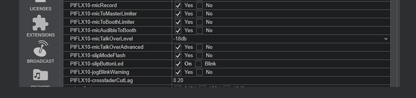

I'm curious the sx3 had a switch for crossfader curve but how do I set cross fader curve with vdj,
I did use it a bit so it must have a default setting?

          Yes, read the manual: https://www.virtualdj.com/manuals/hardware/pioneer/ddjflx10/advanced.html
       geposted Wed 30 Apr 25 @ 8:39 am
          https://www.virtualdj.com/manuals/virtualdj/appendix/optionslist.html
You want the crossfaderCurve option.
Since FLX10 doesn't offer a dedicated control to switch the curve on the fly, you may have to map it on your keyboard, or an empty custom button on the GUI, or a button on the FLX10 itself that you don't use.

I found crossfader in the virtual dj options,
