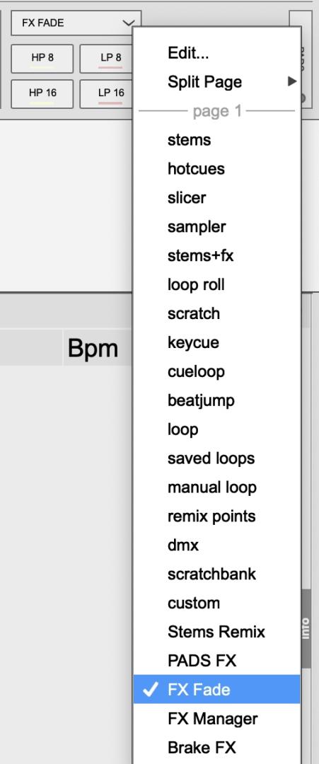

On my FLX10, when I hit the PADFX1 Pad Mode, it goes to "PADSFX". Say I go to edit, change it to "FX Fade" instead, if I then switch to a different Pad Mode Hot Cue or Sampler, etc... when I come back to PADFX1, it reverts to "PADSFX" and not the "FX Fade" I had it set to last.
I reached out to support and they don't seem to understand what I'm trying to accomplish. I hope one of you expert users here will be able to help me with this. So basically, I want the PADFX1 mode to remember my last selection (FX Fade, FX Manager, Stems FX, etc...), even after I've navigated to a different Pad Mode i.e. Sampler, Beat Jump, etc...

Actually you just need to "assign" your renamed pad page to the pad page button.
Here's how to do it:
https://virtualdj.com/manuals/virtualdj/interface/decks/decksadvanced/pads.html#controller
