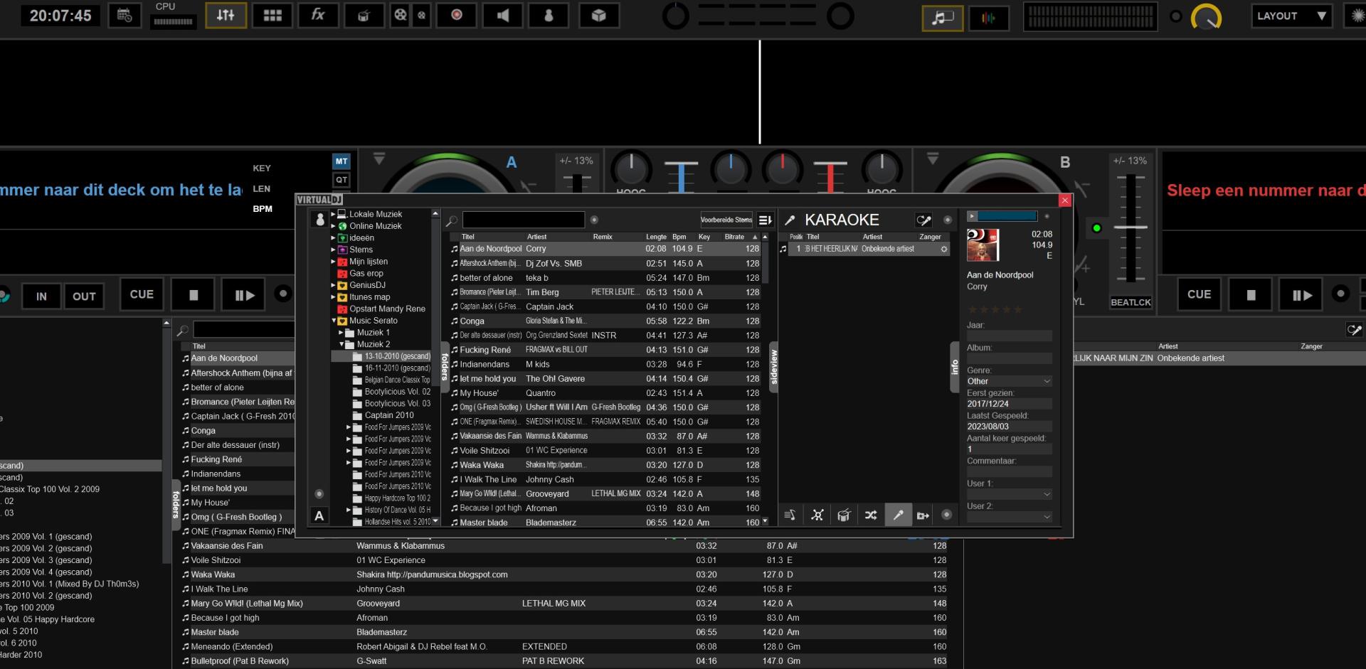

Is there an option to minimize the main window when opening a second window inside the main. Just like the floating browser from the Blocks Skin. This way it can be easy to switch between multiple floating windows on a second (remote) display.
Of course this remote screen have to be connected to your display adapter port, but the laptop display can be closed during the virtual dj sesion and still use the floating windows.
I found that switching between skins is to slow for live performance.
Depending on what you're after there's the minimize action, but also you can hide windows by the same action you used to show them.
So you can use show_window 'alpha' & show_window 'beta' and if let's say window 'alpha' is visible, it will hide it, while showing window 'beta'
