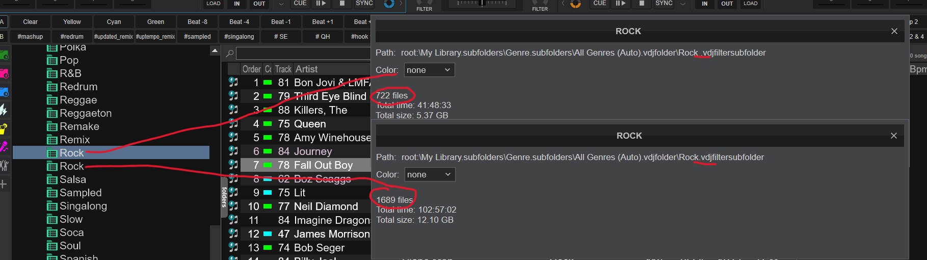

Under my All Genre's I have 2 for Rock one has 722 files and the other has 1689. You can see in the picture there is a space in the Path. I underlined it in Red. Why is this happening?

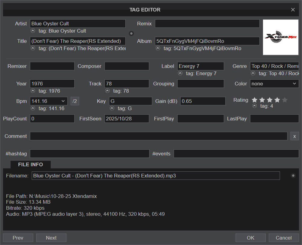

open the tag editor with a file from "rock ", it's probably tagged like that [and 700+ others]
geposted Sun 28 Dec 25 @ 6:49 am

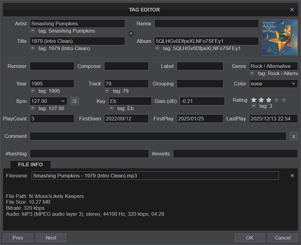

The fear the reaper song shows up in both "Rock" and the 1979 song only shows in the one with 722 files. I don't see anywhere to edit from what I can tell they are both just "Rock"

I hear you on that and I may switch it up. The biggest issue I have is I have thousands of songs that are not like this (other genres) and have the "Space" and don't add the extra genre it's just these 722 songs. I'm just hoping to find out why.

It shouldn't matter if there's a space or not. Perhaps it's not actually a space? (You could try by removing the space and adding it back and see if in which list it shows afterwards)
Edit: Looks like it could happen if you have a song with genre "Rock " without any other genres.
You could find those with a specific filter folter Genre is "Rock "
You could then select them all and replace the genre with just "Rock" without a space

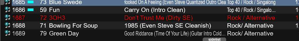

So I've noticed a few things since Adion's post. Any time I have 2 or more Genres and Rock is NOT the LAST one in the list the show up as "Rock " (with the space. I tested this by putting rock as the last on the list and they all went to the correct "Rock". This is not ideal as I'd prefer the Rock genre to be 1st or 2nd.
Example:
Rock / Alternative - shows up as "Rock " incorrect
Alternative / Rock - shows up as "Rock" Correct
My confusion is why is it only Rock not EDM Top 40 Country or any other genre but Rock.

Did you try the filter folder I mentioned to see if you have any tracks that just have "Rock " with a space but no other genres?
geposted Wed 31 Dec 25 @ 6:26 am
Yes that produced the same 722 songs that are incorrect. That's when I noticed that Rock was either a standalone Genre and was correct and I saw I had a handfull of 3 Genre songs and Rock was the last one and and those showed up correctly.
