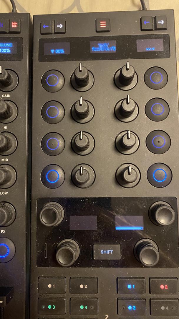

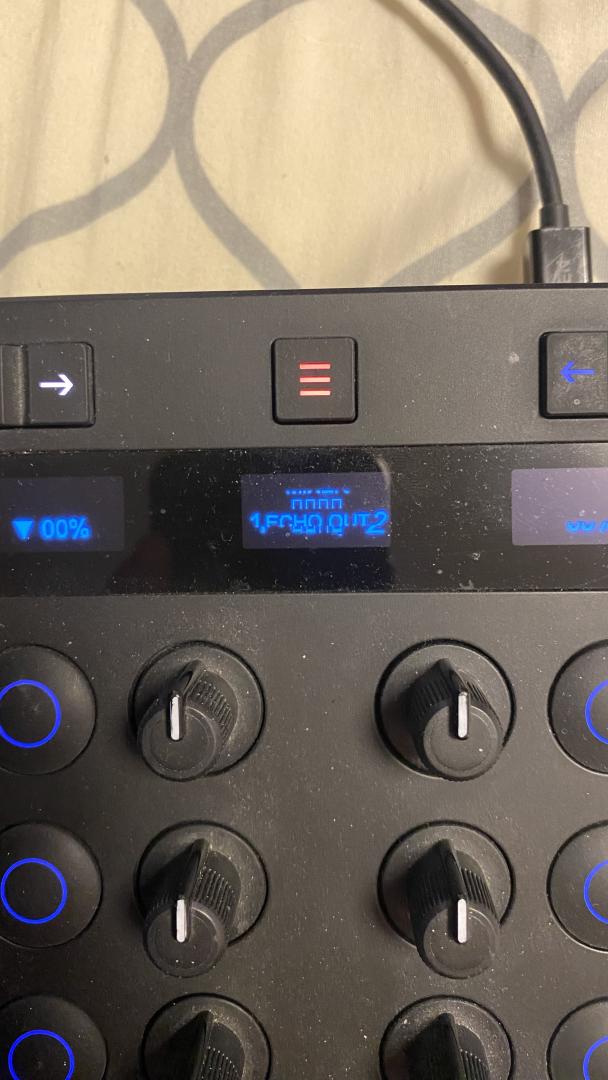

When I connect both of my controllers, Traktor X1 MK3 and Z1 MK2, the screens don't work. When I connect only one of them, everything is fine. Is there any way to fix this bug?

Yes, I've tried all of this. Nothing helps. As soon as I disconnect one controller, everything is fine, but two controllers cause this bug. I have an M1 Pro Mac, Tahoe. VirtualDJ b9004

I installed the latest build 9171 and the situation got worse. When I try to connect with support the feedback form constantly says that you need to try later. How can I let the developers know that this issue needs to be resolved?
