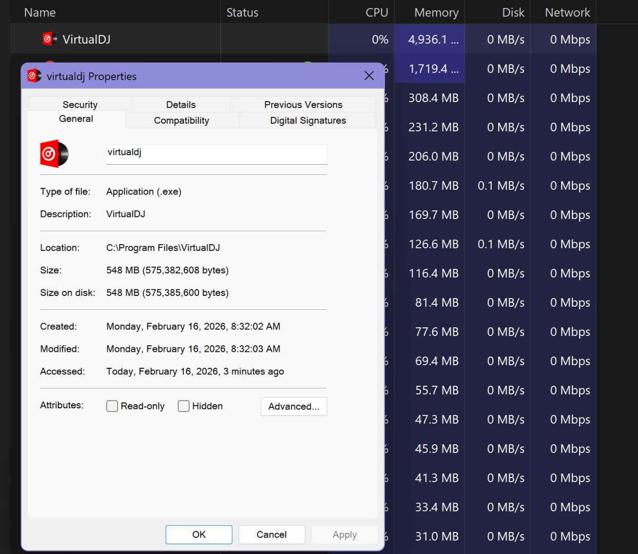

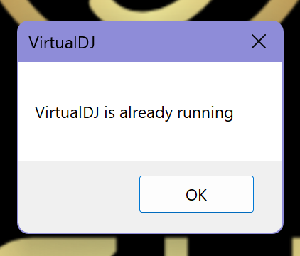

I have had this issue happen several times in the past day. I use VDJ, and exit it. Later I try to go back to it and I get the dialog box about it already running. I go to the Task Manager and try to end the task. But the VDJ orphaned process stays there.
I have tried killing the process by running task manager in Administrator Mode, and that does not work. The only solution I have found is a full reboot. Has anyone else run into this issue recently? What did you do to resolve it?
