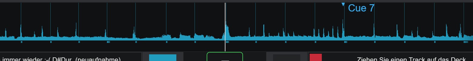

In the past, it was very tedious for me to edit a flexible beat grid manually.
That is no longer necessary. GREAT!!!
First of all Thanks a lot for this! VDJ is and will be the best!
Just one option would still be important:
A ‘Shift All Anchor Points’ option.
With a constant beat grid this was & is possible .
I have assigned this to two buttons so that I can quickly intervene if a drum loop is slightly late.
adjust_cbg -1% & adjust_cbg +1%
Unfortunately this don´t work with the fluid beatgrid.
Sometimes even tiny delays in the grid are enough to throw the sync off slightly.
Some drum loops are also slightly behind. A tiny shift could then bring everything back into sync.
Sometimes you have to find a "beat-compromise"...
In the example, some are spot on and others are too early.
Without the Shift function, I now have to laboriously start editing the individual areas again...
So there is only a tiny gap left to absolute happiness.

With variable grid, it's not possible to move by x ms, as it would throw out all the rest of the grid.
But from what you describe, what you need, is to play with the variableBpmSensitivity setting.
As explained in the other thread, this setting sets the maximum distance (in ms) between an anchor and the actual beat position. You probably want to lower it if you'd rather have very precise anchor position and don't mind many anchors and a fluctuating bpm display.

Thank You Stephane, but it is intentional to move ALL Anchors.
Sometimes there are more beats off and just a few in time.
In the example only 2 of them are exact but 8 are to early.
(And this is nearly the same in the rest of the song)
So move all the anchors at once will change this to 8 exact and 2 are a bit to late.
That would help me a lot,
and also in general it is good to have a Real-time intervention capability.
It´s about minimal shiftings of all anchors just in case of sudden asynchronity.

ok, added for next build
