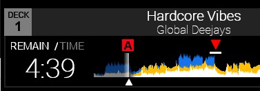

I hope i can expain it well with the help of this video.
A blinking effect under a hotcue is only wanted when the hotcue`s are selected AND not when a
temporary cue is set (the red triangle).
For that i made this stript, but don`t work.

Use this visibility="param_equal 0 `get_cue` ? off : blink 400ms"
geposted Tue 31 Mar 26 @ 10:24 pm
Check!! working 100%
Thnx,
Gr. Marcel
