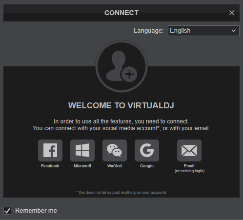

Once VirtualDJ is opened, a Login Window will appear. Login with your virtualdj.com account credentials.
A Pro Infinity or a Pro Subscription License is required to use the AlphaTheta CDJ-3000X with VirtualDJ. Without any of the above Licenses, the controller will operate for 10 minutes each time you restart VirtualDJ.

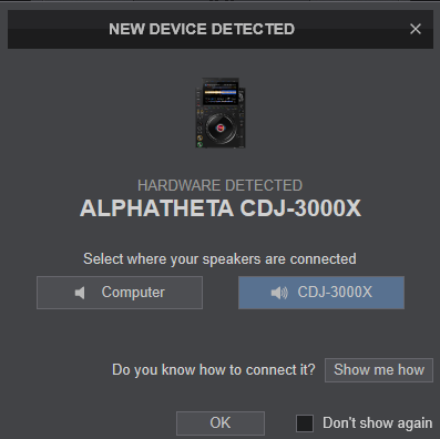

A detection window will appear next verifying the proper connection.
Click on the CDJ-3000X button in case the built-in sound cards of the CDJ-3000X are used and VirtualDJ will automatically apply the necessary Audio configuration. See Pioneer Club-setup Guide for further setup options.
Click OK.

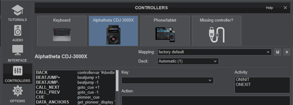

MIDI Operation
The device should be visible in the CONTROLLERS tab of Config and the “factory default” available/selected from the Mappings drop-down list.
Note. Each CDJ-3000X unit (if more than 1 is connected) will be additionally displayed in this window, and any modifications in the mapping file will affect all units.

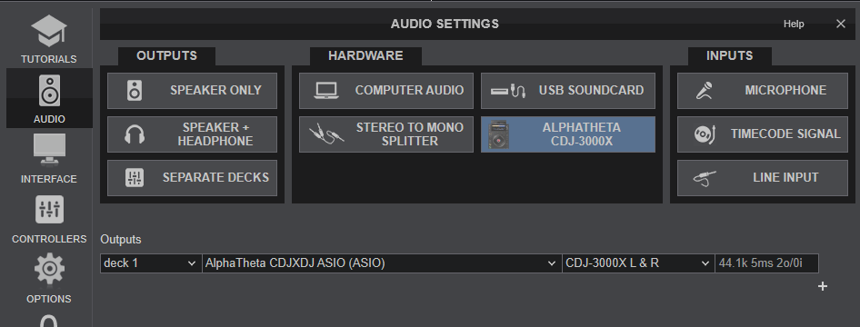

AUDIO Setup
The device has a pre-defined Audio setup and a special button in the AUDIO tab of Config to provide that. Alternative setups can be applied, depending your setup and the available units. See Advanced setup chapter
