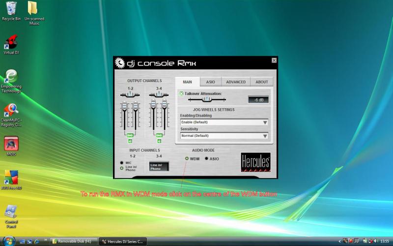

Just had a thought, open the RMX control panel and tell me what you see, or post a screen shot (would be better)
Does it look like this
i.e. slider in the same position.
geposted Thu 08 Jan 09 @ 6:58 pm
Yea it looks exactly like tat and yea I did do the config.

just got my rmx too, i am having the same problem, cant figure it out, at the bottom of the dj control panel instead of having two bubbles with WDM as an option it just has a text box saying "DJ console rmx no.1". Can that have something to do with it,? I use a mac.

@ Dank491:
Since you are on a MAC ( where ASIO does not exist) , it is perfectly normal that you don't have this option.
