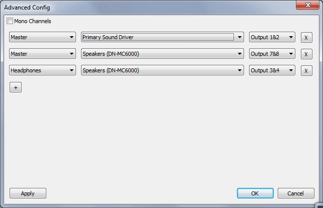

If anyone wants to use the DN-mc6000 in two channel mode (2+3) using Virtual DJ's internal mixer and outputting using your default soundcard you'll need to use the advanced config and set it up like the picture:
mc6000.png" class="bb-img">
If you just use the normal headphones and two card setup cueing does not work correctly.
