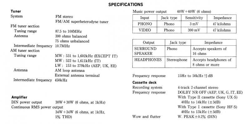

posa watt einai? 34 i 60?
geposted Fri 11 May 12 @ 8:23 am
o enisxytis soy einai 2x30 sta 6 ohm.osos afora to problima,hxeia exeis allaksei?
geposted Fri 11 May 12 @ 11:16 am
kai auto pou grafei pano deksia oti einai "music output 60W" ti enooei?
ixeia den exo allaksei alla logika de prepei na ftaine ta ixeia giati to kanei tautoxrona kai sta 2 ixeia.
opote leo apoklietai na einai ta ixeia....

kati o enisxitis exei logika.. dokimase na valeis kapio allo ixio (oti ixio nane) oste na apoklithoun ta ixia..
geposted Fri 11 May 12 @ 11:35 am
mallon einai h antoxh tvn hxeiwn.ekeina ta xronia grafane diafora.Dokimase se parakalw ena allo hxeio !
ayto einai to service manual http://elektrotanya.com/sony_hcd-a290_lbt-a290-sm.pdf/download.html
