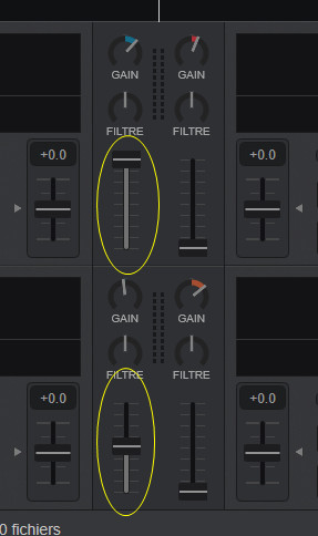

When all faders are down on the MCX8000 and I connect it to VDJ :
- The 2 faders on the left (3-1) are up => abnormal. Work only with VDJ.
- The 2 faders on the right (2-4) are down => normal. Work with VDJ & Denon
When I move down the faders 3-1, I can see on VDJ, kind of "shadow" faders that could explain the issue I have.
How can we fix the issue ? Is there a mapping to check / modify ?
Thanks

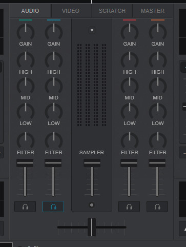

Normally this shouldnt happen. The MCX8000 has a "mechanism" to report the positions of all faders and knobs and is included in default implementation of VDJ.
Is this happening all the times, or randomly ?
Does it matter if you connect Denon before or after VDJ is started ?
If you choose a "full" 4ch-mixer view (with all Gain, EQ, Filter, Volumes for all 4 ch) such as the one in the Pro-layout of the default skin, position the hardware faders and knobs to random positions and open VirtualDJ, do their positions match with the software ones ?
Or the issue is just with the Vol Faders ?

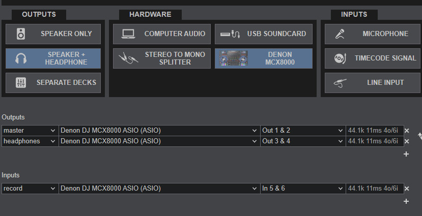

My current outputs settings are these ones below
It happends all the time, whatever if I start VDJ or Denon first.
If I use the pro-layout of the default skin, only the 3-1 volume faders don't work (all other faders or potards work).

If I play a track on deck 3 or 1, I have to control the volume directly with VDJ (no action with the Denon fader), and I have no information about the track on the screen for the left side of the MCX8000 (only "Denon DJ MCX8000").
When I move the 3-1 faders on the Denon, it moves very slightly on VDJ, as if it were ‘frozen’ or blocked by a setting. That's why I'm surprised to see these kinds of ‘shadow’ faders on my previous screenshot.

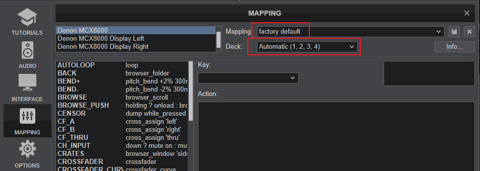

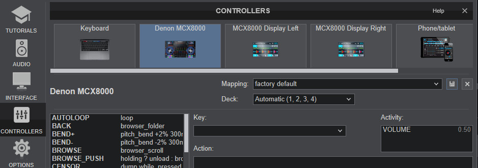

Let's first try to see if we all have the same starting point.
- All 4 Input Select switches are at PC at the top mixer panel
- Use the default Audio setup
- Use the Factory default Mapping.
- Use the default 4 Decks Pro layout skin to see all 4 Mixer Channels
For VirtualDJ normally shouldn't matter the Build - nothing is changed in between - but proffered to use the current Public one.
Do you see get the same issue with the above ?

BTW, i just tested with Build 8741 and everything works as expected incl Vol Faders init positions.
ASIO Driver, Firmware to the latest version., default Audio setup, Default Mapping and default Deck Assign (1,2,3,4)
Also did a "Factory Default" reset - just in case a setting was set differently here - by entering the UTILITIES Menu

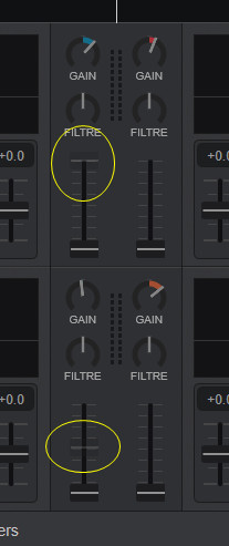

Hi,
- I didn't have a crash with VDJ or Windows.
- I always launch VDJ manually.
- I have an Internet browser open.
If I disconnect the MCX8000, I use the default audio configuration, the default mapping, the default pro 4-deck skin.
After restarting VDJ, so I have the result below (and I don't see "shadow" faders for the 3-1.

If I reconnect after the Denon, I have the same issue as before with the 2 faders
