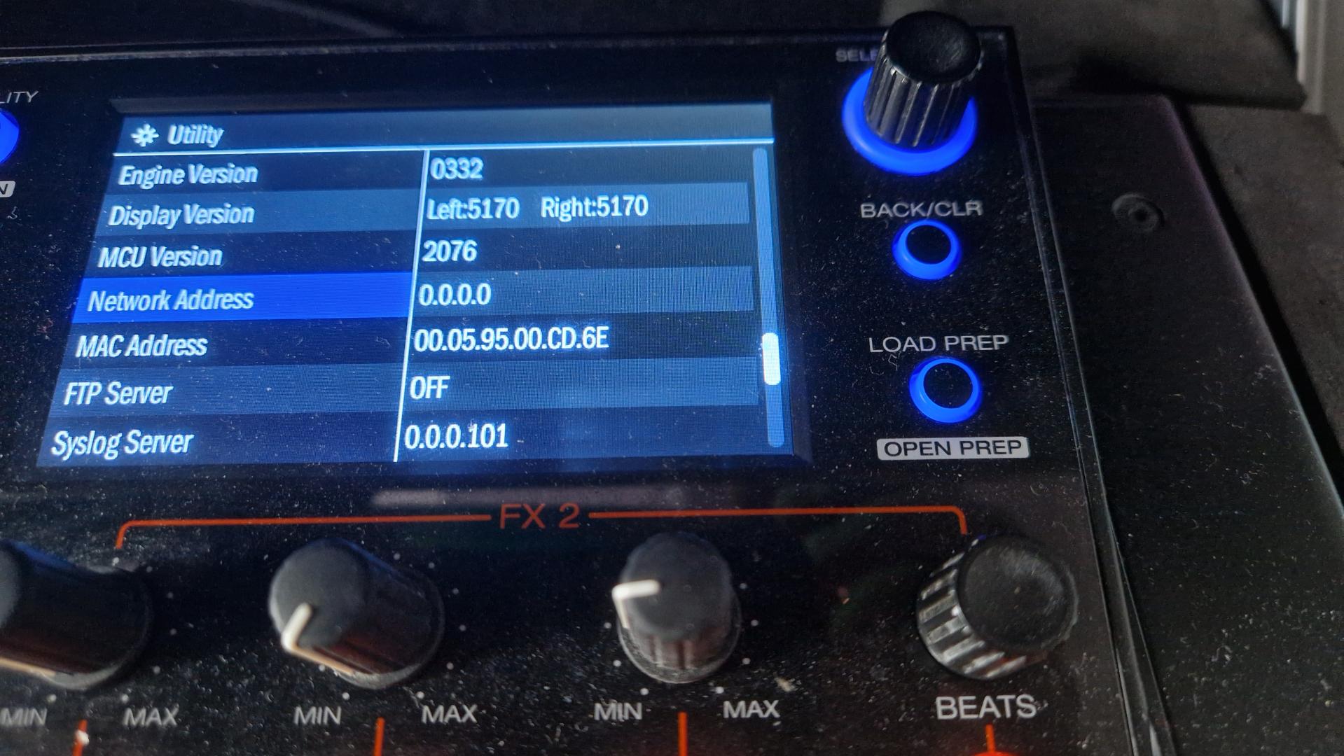

Firmware versions (from Utility screen):
Engine Version: 0332
Display Version: Left 5170 / Right 5170
MCU Version: 2076

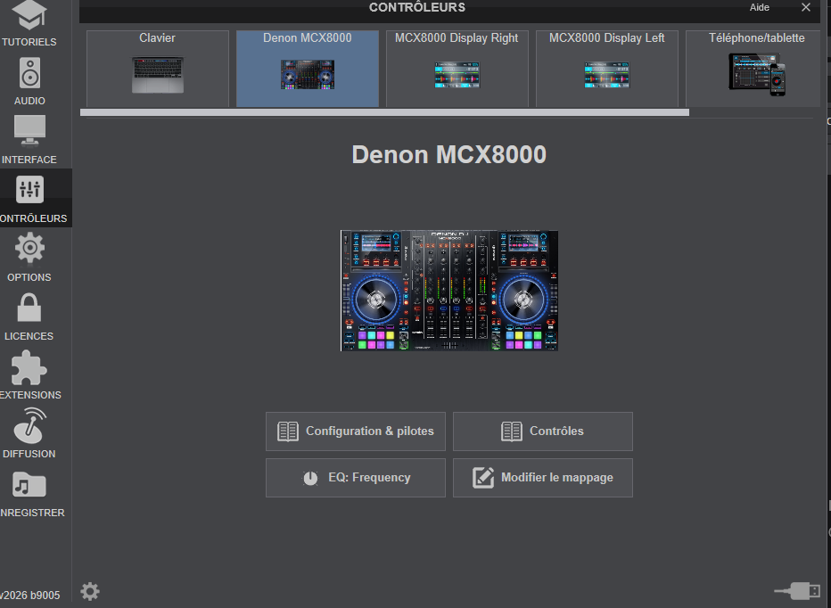

VirtualDJ starts correctly, the controller is properly detected in the Controllers tab, and audio works.
However, I have the following problems:
1️⃣ FX Issue
On both decks:
FX Button 1 → FLANGER STR → does NOT work
FX Button 2 → FILTER LP POS → works
FX Button 3 → FILTER HP POS → works
If I change the effect assigned to FX Button 1, it still does not respond.
This happens on both decks.

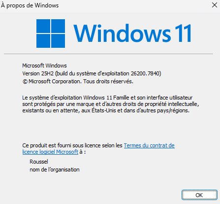

Computer: PC Windows
Operating System:
Windows 11 Home
Version 25H2
OS Build: 26200.7840
MCU Version: 2076

🔎 System Configuration
Main Computer (problem machine):
Windows 11 Home
Version 25H2

Firmware versions:
MCU Version: 2076

🎛 Issues Observed (Windows 11 PC Only)
1️⃣ FX Issue (both decks)
FX 1 → FLANGER STR → does NOT respond
FX 2 → FILTER LP POS → works
FX 3 → FILTER HP POS → works
Changing the assigned effect does not fix the issue.

A compatibility issue with Windows 11 25H2 (build 26200.7840)?
A problematic Windows update?
A conflict with VirtualDJ 2026?

Please open VDJ Settings->CONTROLLERS tab , select the MXC8000 from the top , then click on "Edit Mapping"
If you move the FX1_PARAM knob, what do you see in the "Activity" window ?
Reference of Manual : https://www.virtualdj.com/manuals/virtualdj/settings/controllers/index.html#custom%20mapping

It appears that there is a generic MIDI issue with the latest Win 11 updates.
Please see .. https://www.virtualdj.com/wiki/Win11-KB5074105.html
If your last KB installed later than the one mentioned above in the Wiki, uniinstall them all up to the latest (so anything later than the KB5074105)
We have identfied the issue and reported to Microsoft. A fix will be rolled out soon i guess, but no ETA.
In the meantime, the method above ensures that your MIDI will work properly.
