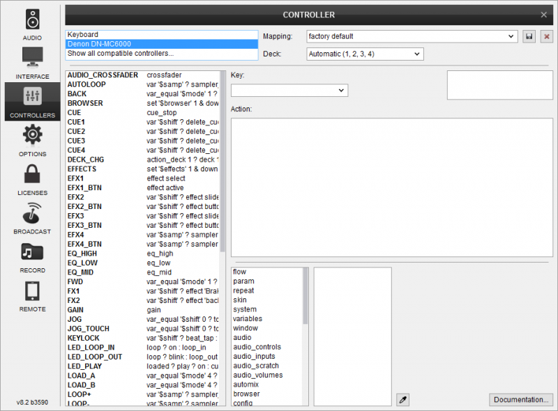

Midi Operation
The unit should be visible in the CONTROLLERS tab of Config and the “factory default” available/selected from the Mappings drop-down list.
Find more details at
https://www.virtualdj.com/wiki/VDJ8script.html
